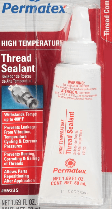

high tack or aviation sealant or pipe thread sealant
I've always had good luck on threaded pipe joints with the PTFE liquid pipe sealant.. use it all the time, coolants, oils, fill/drain plugs..
Appreciate the suggestions. Probably can’t go wrong with the Permatex and I can pick it up at the auto parts store. Thanks again!
For PTFE tape applications, I use Blue Monster. I've given up on everything else. Permatex No. 2 should work on the cooling system application being discussed, though.
