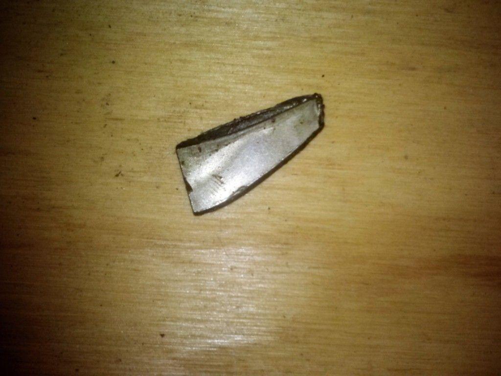

When i changed out my eng oil psi regulator i found and pc of metal in the water jacket behind the regulator/oil cooler housing.... I thought it looked like a water pump impeller blade ???

Do you notice the engine temp is higher than usual? Or see water dripping from the water pump when the engine is at temperature and running? I would think that if an impeller blade made it to the outside of the water pump you'd bee seeing more than a drip.

Also, my old pump has all its blades... But the steel pc shown in post #1 def is a pump blade. Matches right up... Once a-pun a time, I wonder what happened......:confused:
Old pumps bearing had some play and feel rough
CSI: Water Pump (Queue music: "The Dirty Jobs", by The Who). I wonder if someone changed it years ago and the housing was bonded to the engine. They may have tried to pry it off, and snapped a blade in the process when it came loose. Or worse, they were installing the new one and broke a blade while trying to force it into position. If you had one of those new CSI6000 Pro machines you could put the blade in it for analysis, and it would kick out the result in just a few minutes, all while you were engaging in idle chitchat with your hot and curvy coworker.
