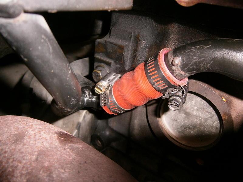

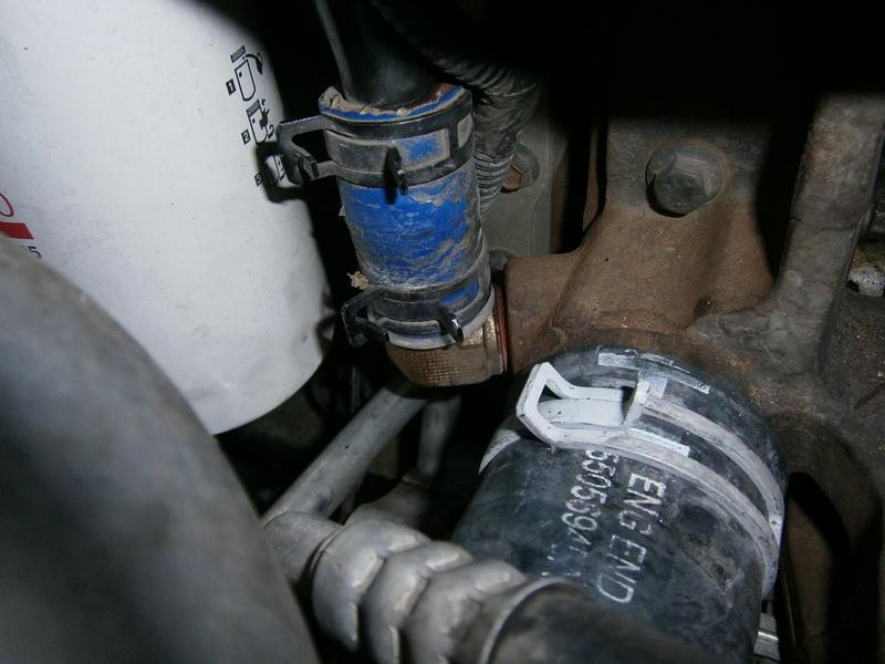

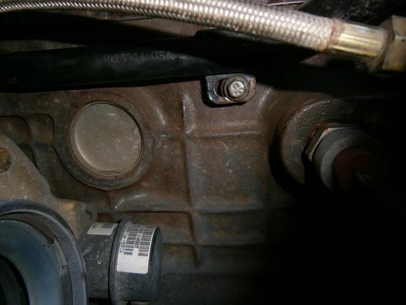

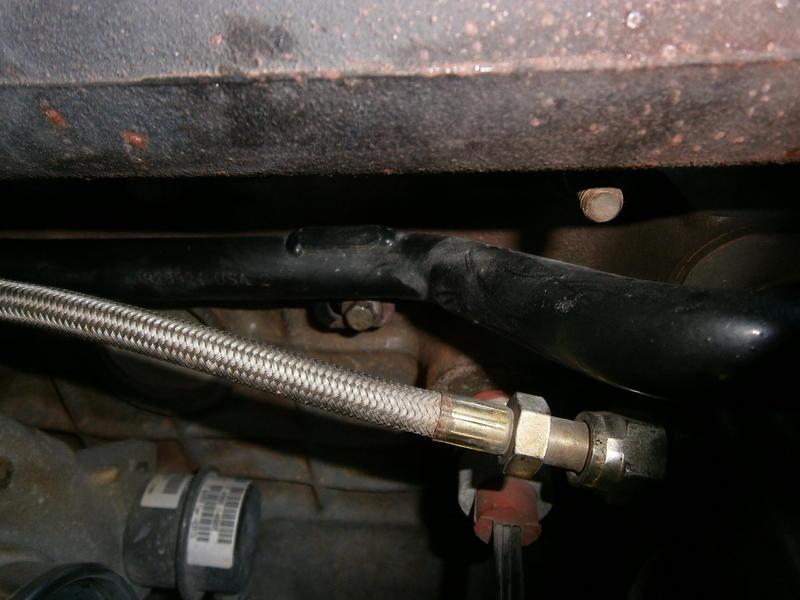

The neighbor came down and asked me to give him a hand on his 06. He got the old hose off by cutting it but could not get the new one on. If you look at the photo of the new hose installed you can see a goober that is on the top pipe. It would not come off and kept the hose (that is very flexible) from pushing on far enough to get it over the lower pipe. Photos were an after thought, but removed inner fender, moved generator, front pipe hose lower clamp by oil filter, front pipe bolt to block, and turbo oil feed line to get front pipe to rear pipe gap larger. Sounds like a lot of work, but it really made it easier. Had that goober not been there it would have been a 10 minute job. Unfortunately he didn't get the spring clamps. If he had the job would have been tough without the good remote spring clamp pliers. The normal spring clamp pliers would be tough to get back there.
Top photo, 10mm bolt on front pipe. Second photo, same bolt and turbo oil feed line. Third photo goober on top pipe that kept hose from being slid all the way up. Last photo slide lower clamp up on blue hose so pipe can be removed.
The new hose is very soft and flexible, nothing like a "normal" heater hose. Yes the photo makes it look easy, no access to get in there and knock or grind it off. I thought it might be a glob of paint, but it didn't budge with a screwdriver.
see that would bug the crap out of me with those clamps not being turned the same way. I'd have to take one off and flip it over.
Wingate and Dave, I like to do things "purdy", too, but I like maneuvering room even better. Which are the best clamps to use now? The screw-tite or the spring?
for that line i would use the spring clamps so they self adjust....this job is way to hard to have to go back and adjust the clamps again....
