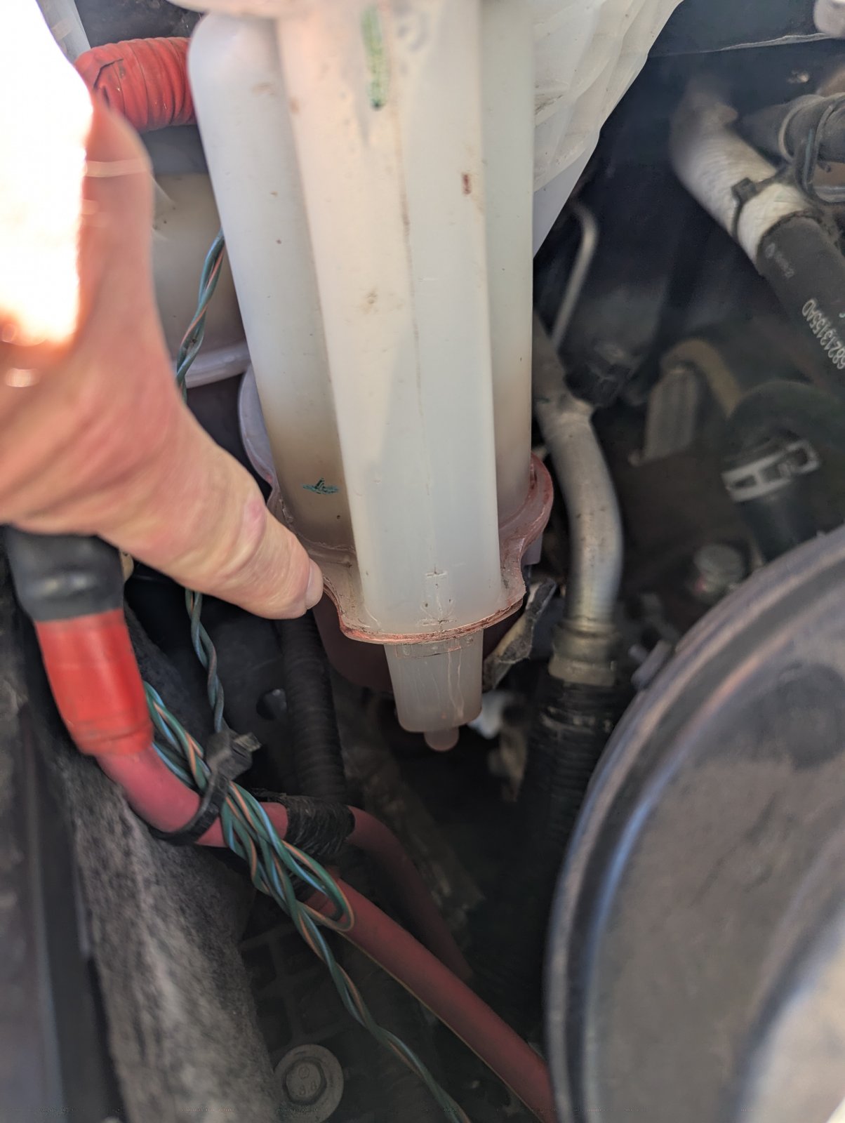

Interesting thing is happenign to me right now. I had smelled some coolant leaking under the hood and added a couple of cups of water the past month. Added some floresant dye to the coolant to trace the fluid loss.
What I found is the Coolant tank splitting along the top and bottom seam.
Wondering if any one else has had this and how long it takes before it pops. of course, I would find this out
a couple of days before a trip.
looking at parts availability, it seems my usual sources are a week out. Local dealer is a couple days out.
I may just use a Radiator tank 2 part expoxy to mend it till I get a new tank.
Comments appreciated.

Interesting my info did not post on the bottom(will look). yes, 2016 3500 Aisin HO. 166k mile on it now.

Well, the Dorman product I recieved worked perfectly. Made in Taiwan. Looks to be an exect copy of the original. Only thing I transferred was the Heat shield form the old Tank to the new one with some 3M 77 Spray adhesive. Took my time after seeing a couple Youtube videos. 4 hrs. Got tank from Napa with 20%off online coupon. Ordered it and picked it up.
One thing I did notice was the Turbo air inlet hose had pushed up against the Turbo outlet hose and Rub thru some of the Silicone
and made a thin spot. Another hose to replace. I had read about these two hoses rubbing together, but had not checke it out yet.
Well gald I did. As I need a new one soon. Nice to be forewarned about an issue, and not trying to fix on side of road.
Is this where your's was leaking from? If so looks like mine may be on it's way out.
