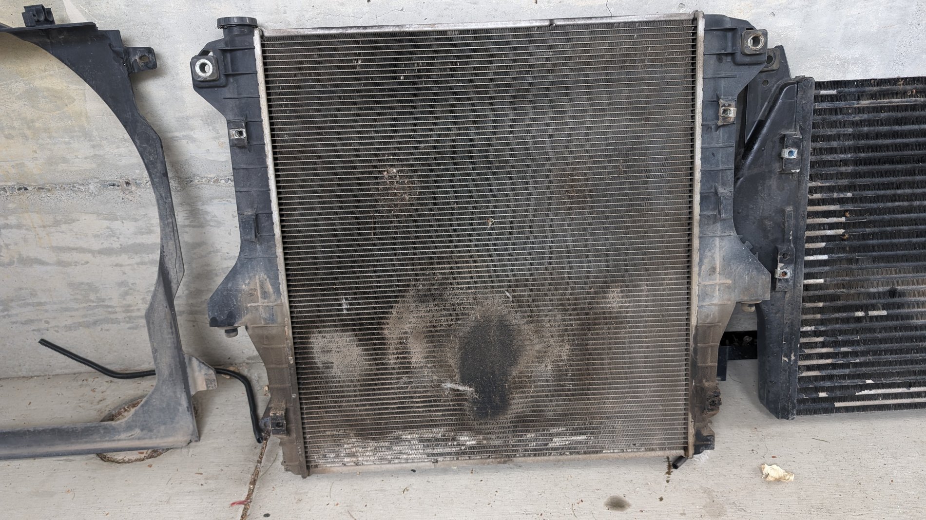

My radiator after 10 years and 100K - same problems as you experience.
Cleaned the whole stack thoroughly and all is good again.
That is what my Kubota turbo diesel tractor looks like at the end of each season. Luckily you don't need to remove much to get a good clean.
Oh, and don't use a pressure washer!!!

My '17 had cooling issues as you describe. Ended up being two issues, one computer, one mechanical. Replaced the radiator for the mechanical issue, made a significant improvement. I also did the chemical flush of the cooling system (MOPAR flush solution), I could not believe the amount of crud that came out. If you hear your fan spooling up and it's really howling when you hit 235* and you see a temp drop, it's not that.
