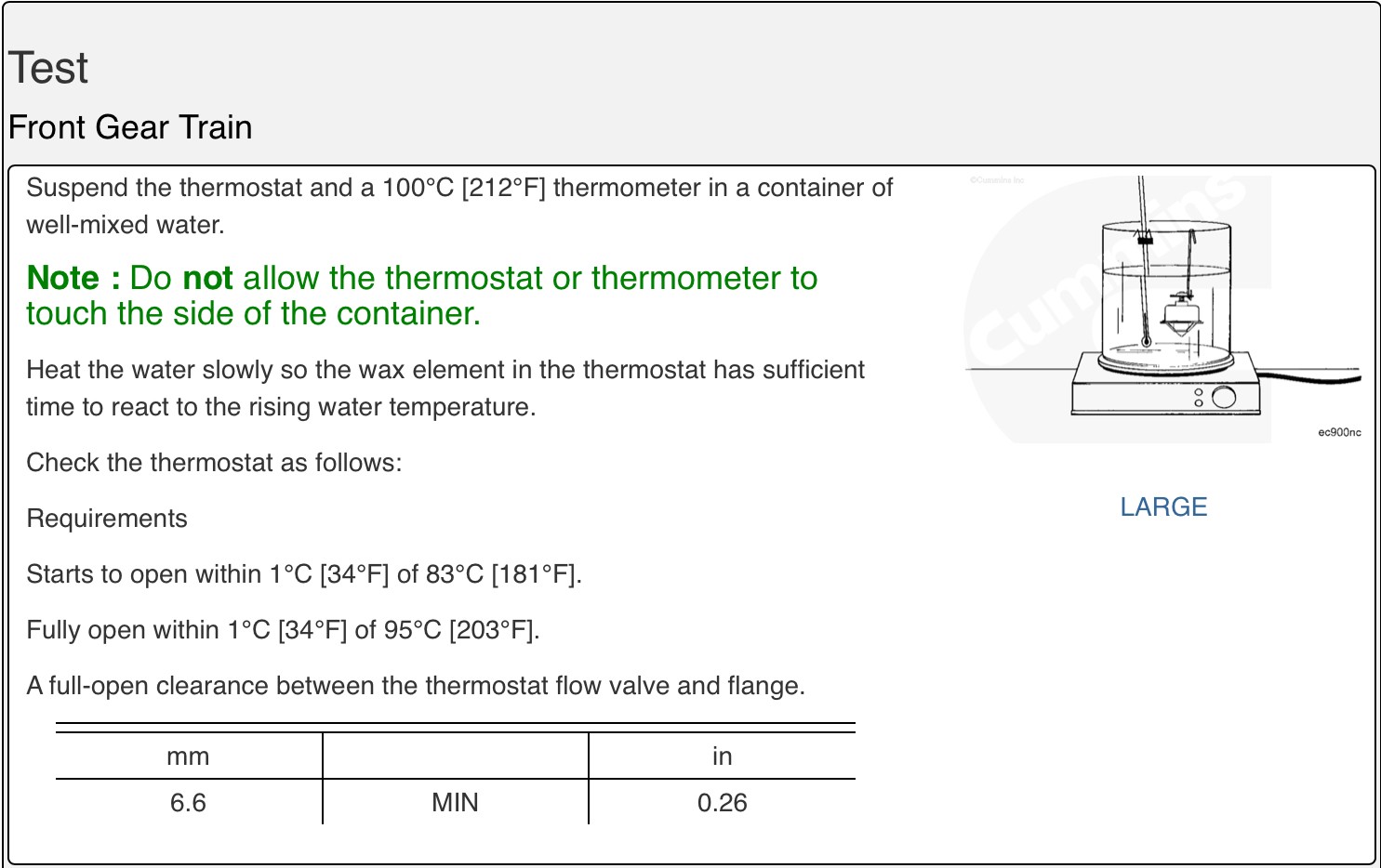

I used to think the same thing too. To a degree, as mentioned above, those factors can and will affect engine coolant temperature. The thermostats are designed to fail in the open position, thus allowing coolant to circulate continuously, noted by very long times to warm up and almost never reaching full design operation temperature. In the event of a thermostat failure such as this, replacing the thermostat will address the problem. This was what happened on my truck and the wife's truck. Even with a new thermostat operating properly, extended idling, static speed driving with little to no load on the engine, and operation in very cold temperatures result in full operating temperatures not being maintain, reached, and/or fluctuation. So, to some degree, this IS normal, HOWEVER, under most normal operation conditions it is NOT. If your engine is not or never reaches full operation temperature under just about all conditions and temperature fluctuates significantly during normal conditions, the thermostat is a very likely culprit. In cold climates, many remove the radiator fan altogether or block off airflow from the grill. I close off the 4 openings in the grill with plastic inserts that I purchased many years ago from a TDR member who sells them on the forum. The lower opening through the bumper allow more than enough cooling air and in many case still too much. Reaching full operating temperature is essential for proper engine operation, longevity, lube oil life, and best efficient operating conditions. Do what you need to do to make your Cummins engine operate properly.I look for it. The fluctuating lets me know everything is working as it should. Nothing but genuine Cummins t-stats in my engine.
Sorry Chief, I totally disagree. This t-stat isn't my first rodeo and the engine isn't the first one in the truck. Every t-stat and every engine has operated the same. I've operated in sub zero temps in northern Alberta in the winter and have never felt the need to block my radiator to get sufficient heat in the cab. A healthy cooling system, a working t-stat and a good heater core is all you need.
With the exception of extreme/abnormal operation conditions. You're are not debating the point with me but with Cummins. I go by what the manufacturer/designer calls for. As I said above do what you need to do to make your Cummins operation properly. This implies following the FSM and Cummins recommendations.A healthy cooling system, a working t-stat and a good heater core is all you need.
You just made my point for me.
