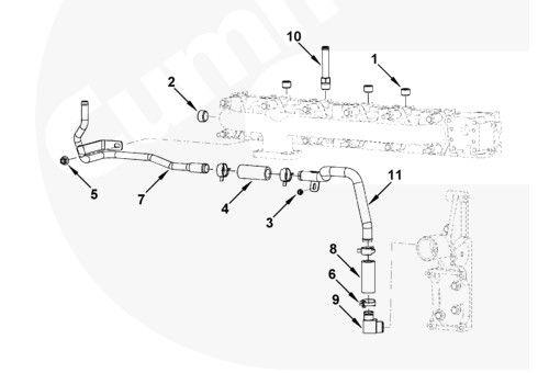

On the passenger side of the engine, there is a hose about 4-6 inches long that connects two pipe ends. Mine is dripping and I'm going to take to my mechanic to change as it looks a bit hard to get to for an old guy. What I want to know is what to call it, except that 4-6 inch long hose on the passenger side of the engine, so that I don't sound like a goober.
Thanks
Cabin heater plumbing hose. The horizontal one is 3820663, the vertical one is 3967022. Both are called "plain hose" in the parts list items 4 and 8.
That was a known issue and the new hose is a kit with clamps that corrects it. Don't take the shortcut of using the wrong clamps or you'll end up with more dripping!
