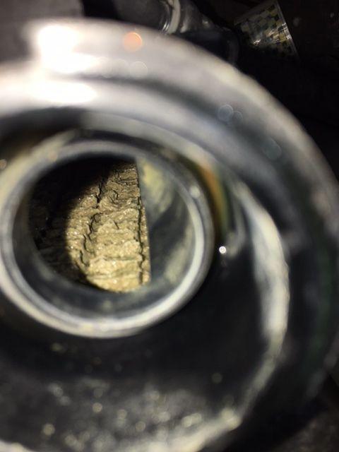

SAndreasen, yea Ive driven it for about 3 hours worth now. When I drained my coolant to put the flush/distilled water in, I took a peak inside the radiator. Ill attach a pic below. With what Ive seen, and living in Phoenix where the daily temp has exceeded 115* on the reg, I went ahead and bought a new radiator, water pump, thermostat, upper/lower hoses, rad cap and fan clutch. With these temps Id rather have the piece of mind knowing I did the work and the components are new. The radiator is original. Oh and when I drained the coolant it was nice, bright green. The radiator looks like it may have encountered oil once upon a time. That or just build up over 20 years...
And sorry, my initial complaint is sitting in traffic the ac stops blowing cold (70*) and the temp gauge starts climbing (3/4). When Im moving the temp stays pegged at 190 and the ac blows 41*. My fan clutch spins by hand with little friction but does not keep spinning when I let off. Im hoping this nasty radiator is the source of my issues.... Thoughts?
NIsaacs, thought I filled out my sig but apparently it didnt take.. Anyways, Ive got a 97. And thank you for posting that link. I previously read that thread. I ordered a Spectra Premium CU1553 (rock auto/napa etc). It seemed to have decent reviews but we'll see. Everything Ive read stated the 97 5.9 came with a single row radiator.
