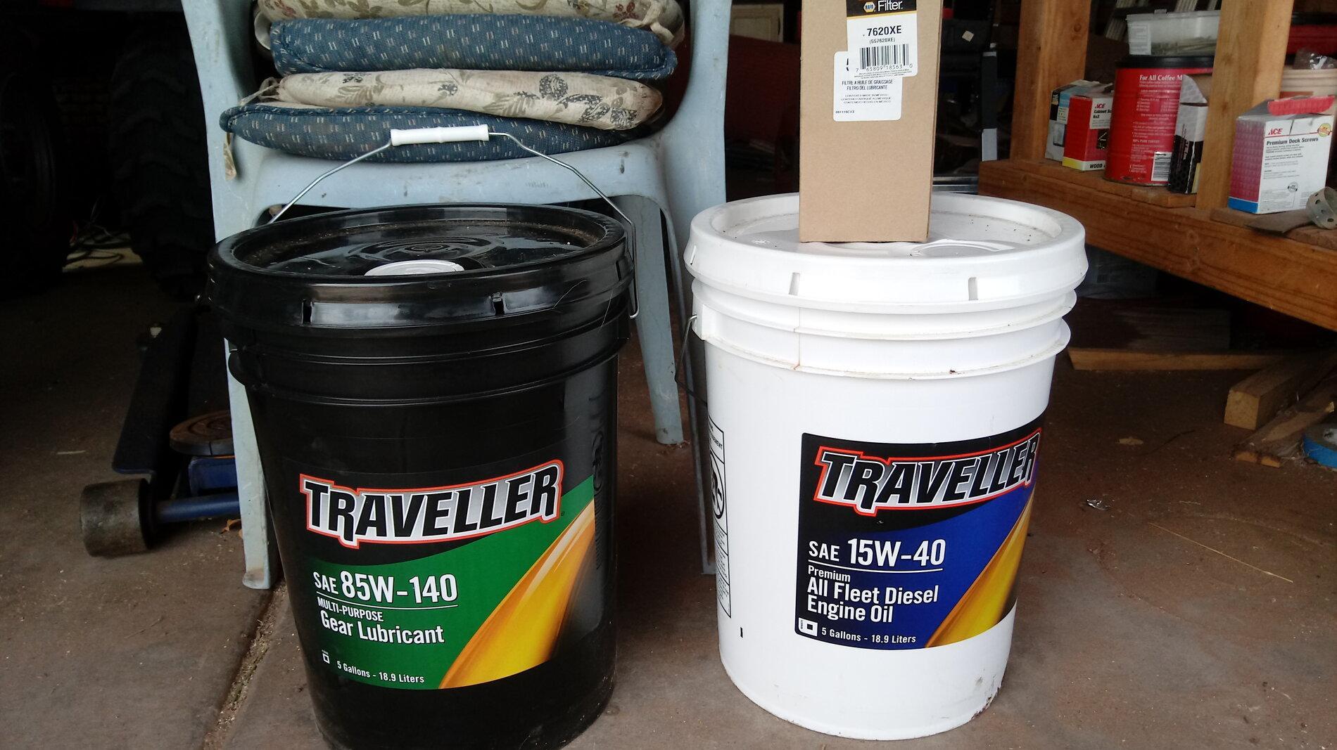

I use a lot of TSC, I think it is made by the same company.
When I was working at a Toyota dealership many moons ago, we learned that there are only so many refineries processing oil and antifreeze. When you look at all the brands out there, they don't all add up! Many of the oils will come off the same line with just different additive package and dye. As long as the oil is specified correct for what you're putting it in, you're good. Warren Mfg has been around a long time. Will be using TSC (warren) on next oil change in the fall. These private label brands don't have to spend $ on advertising which those savings are passed on to end user. The biggest thing we learned was to NEVER use recycled or blended products! Recycled speaks for itself, but on the blended, you have no idea what it's blended with! Was told this meant left other oil purchased at closeout and thrown into a big vat and poured into bottles sent out for sale. Hope this helps. Just keep good fresh oil in these motors! It's their life blood!
