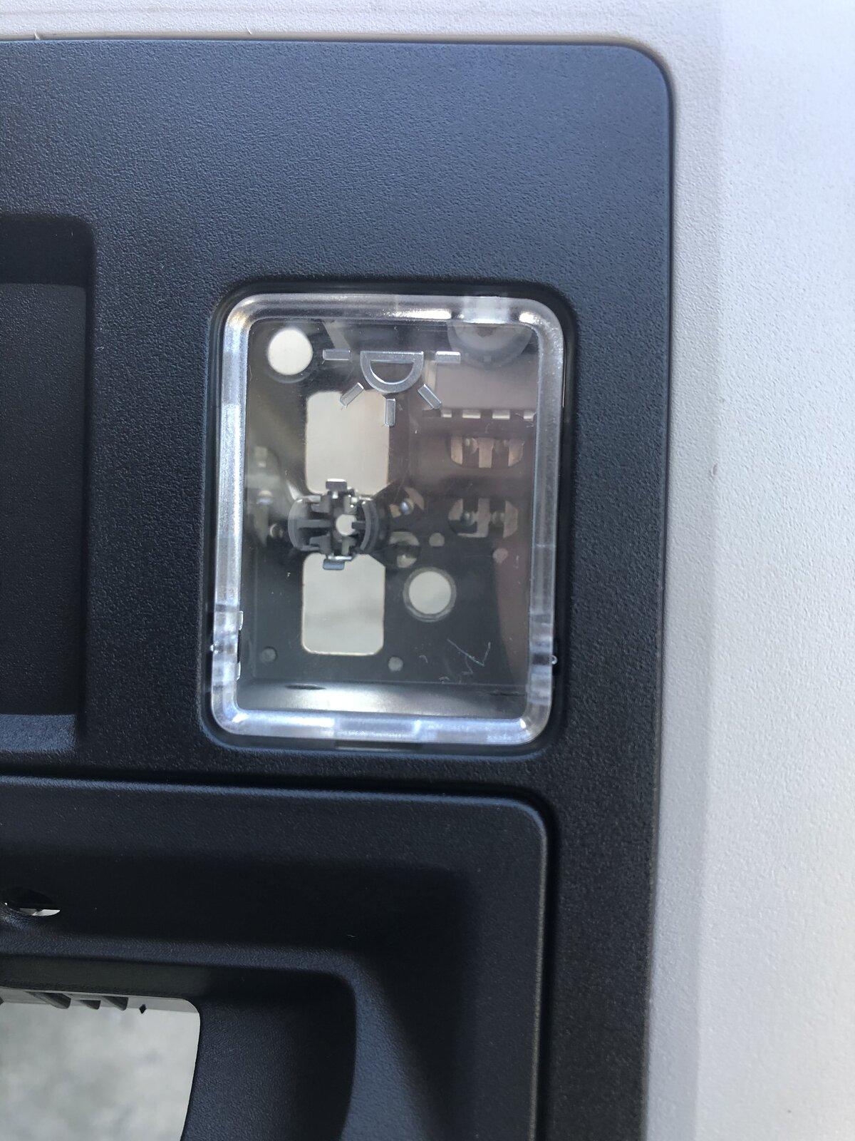

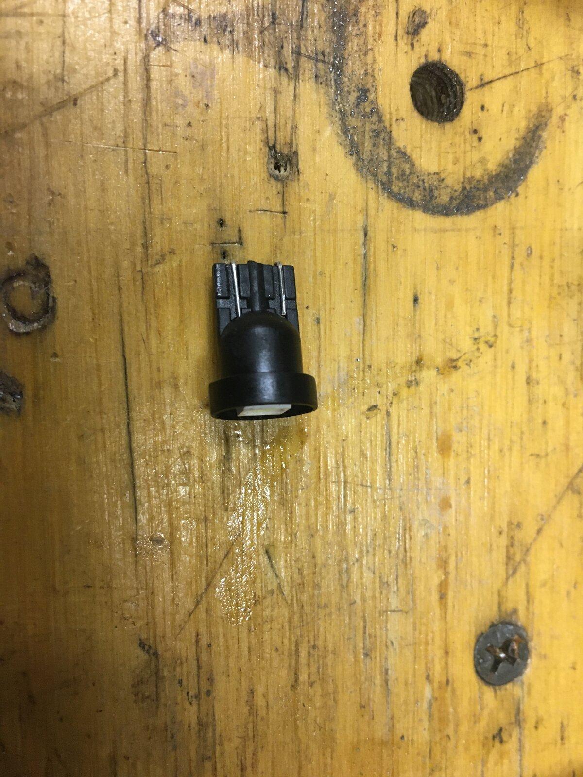

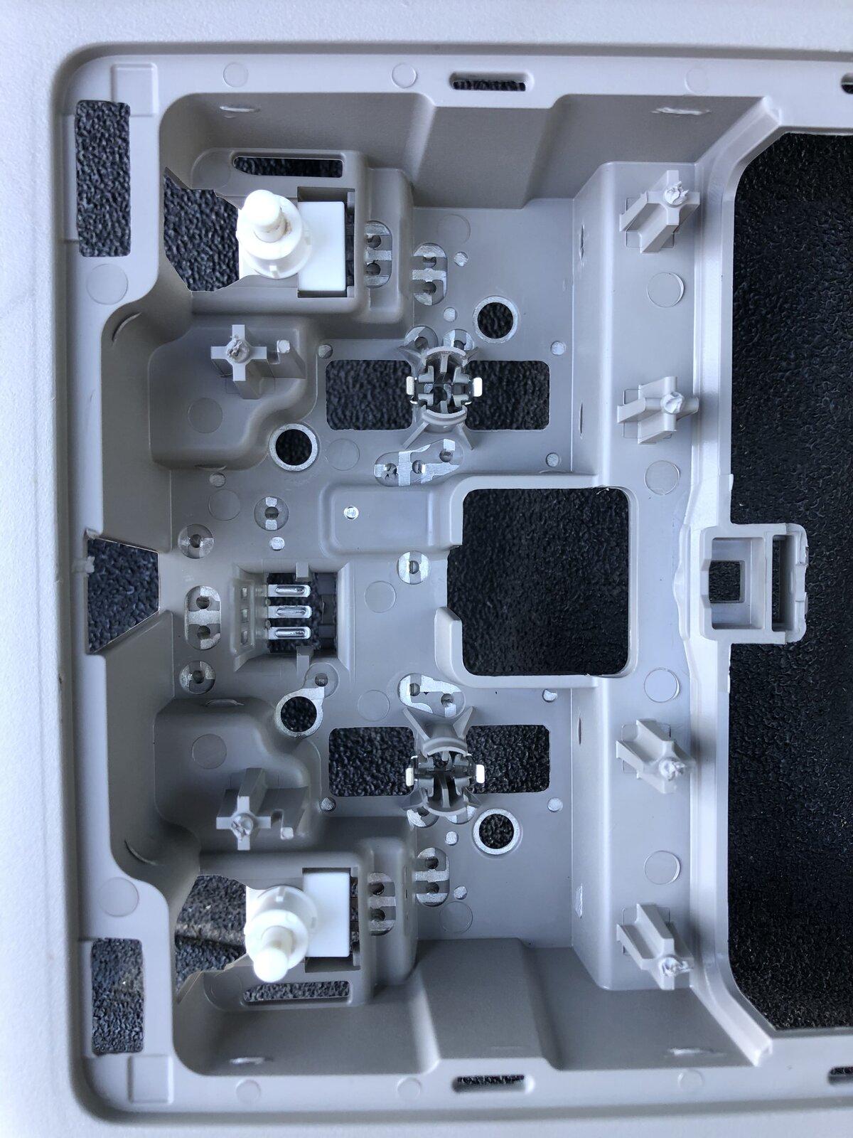

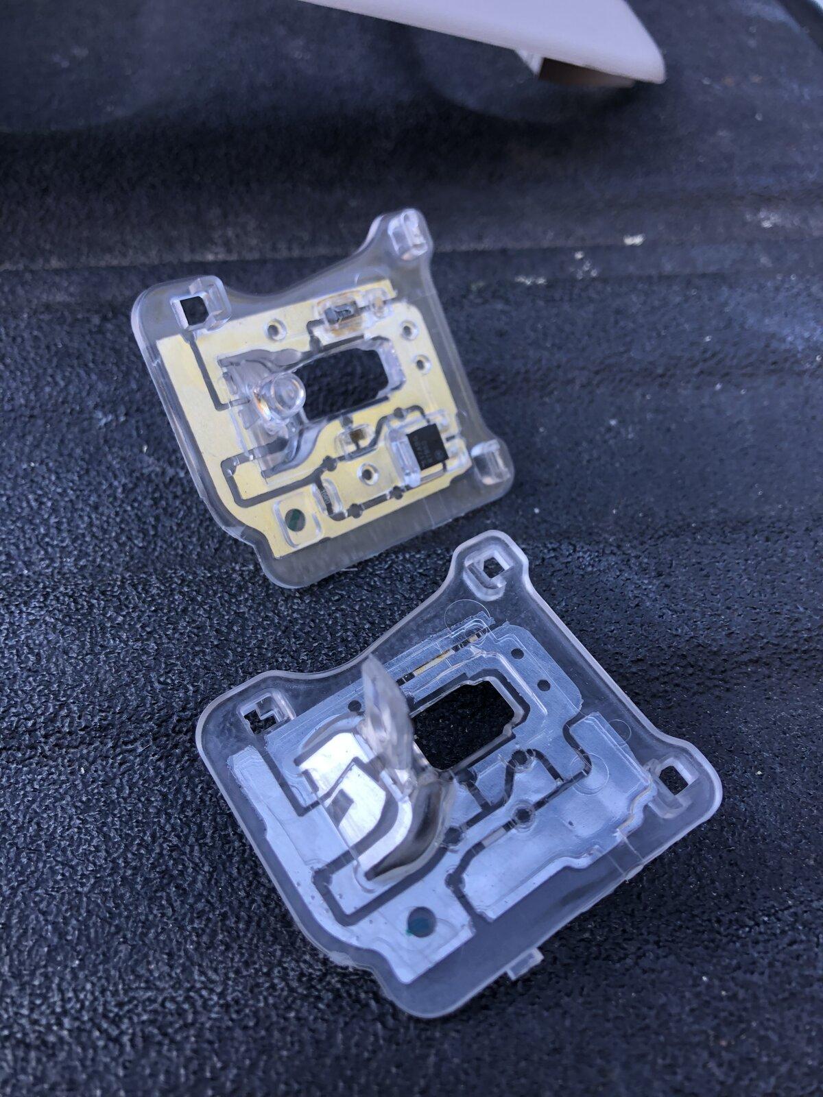

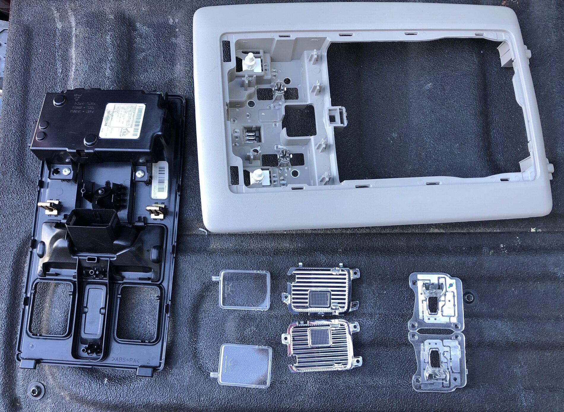

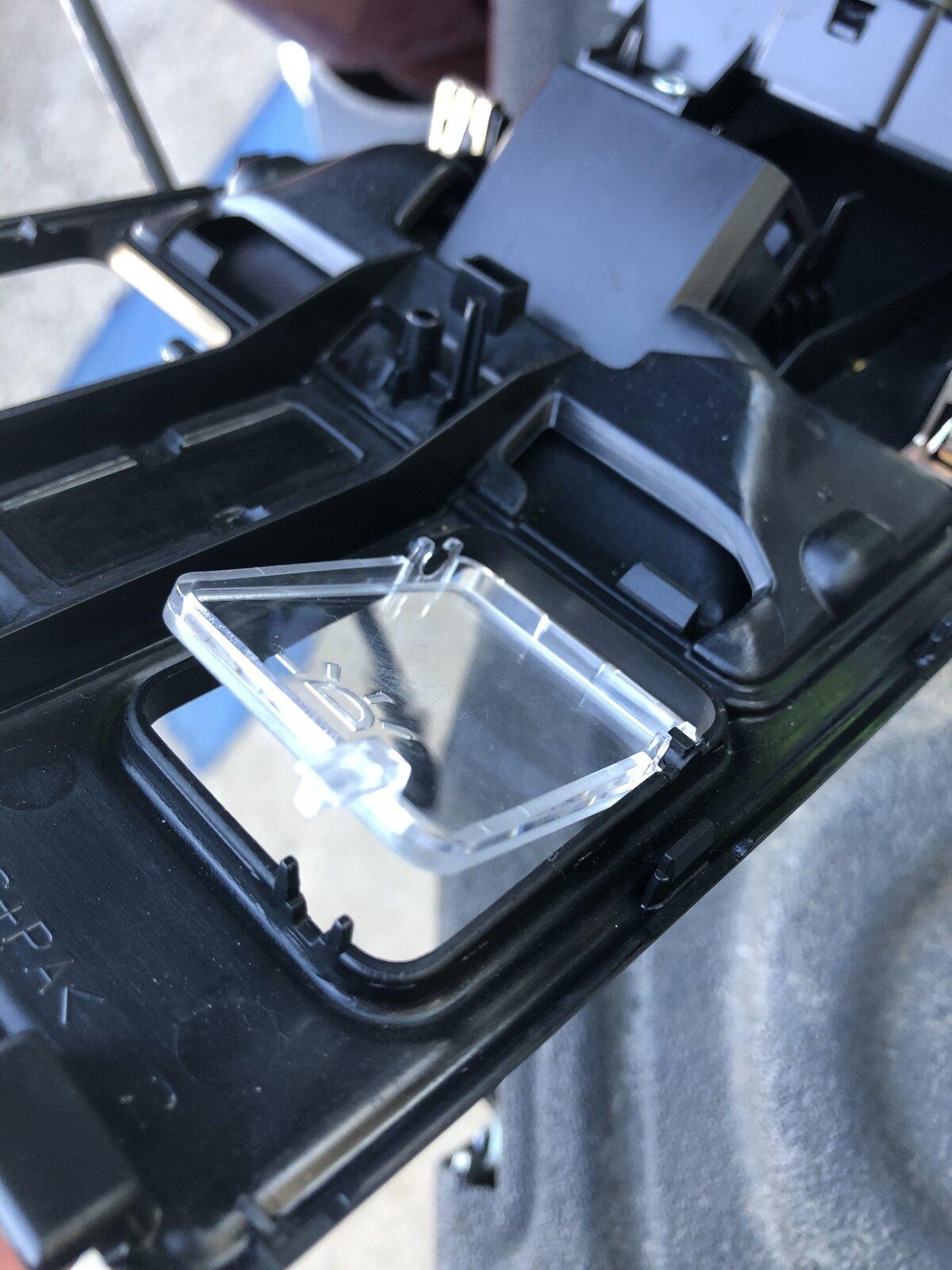

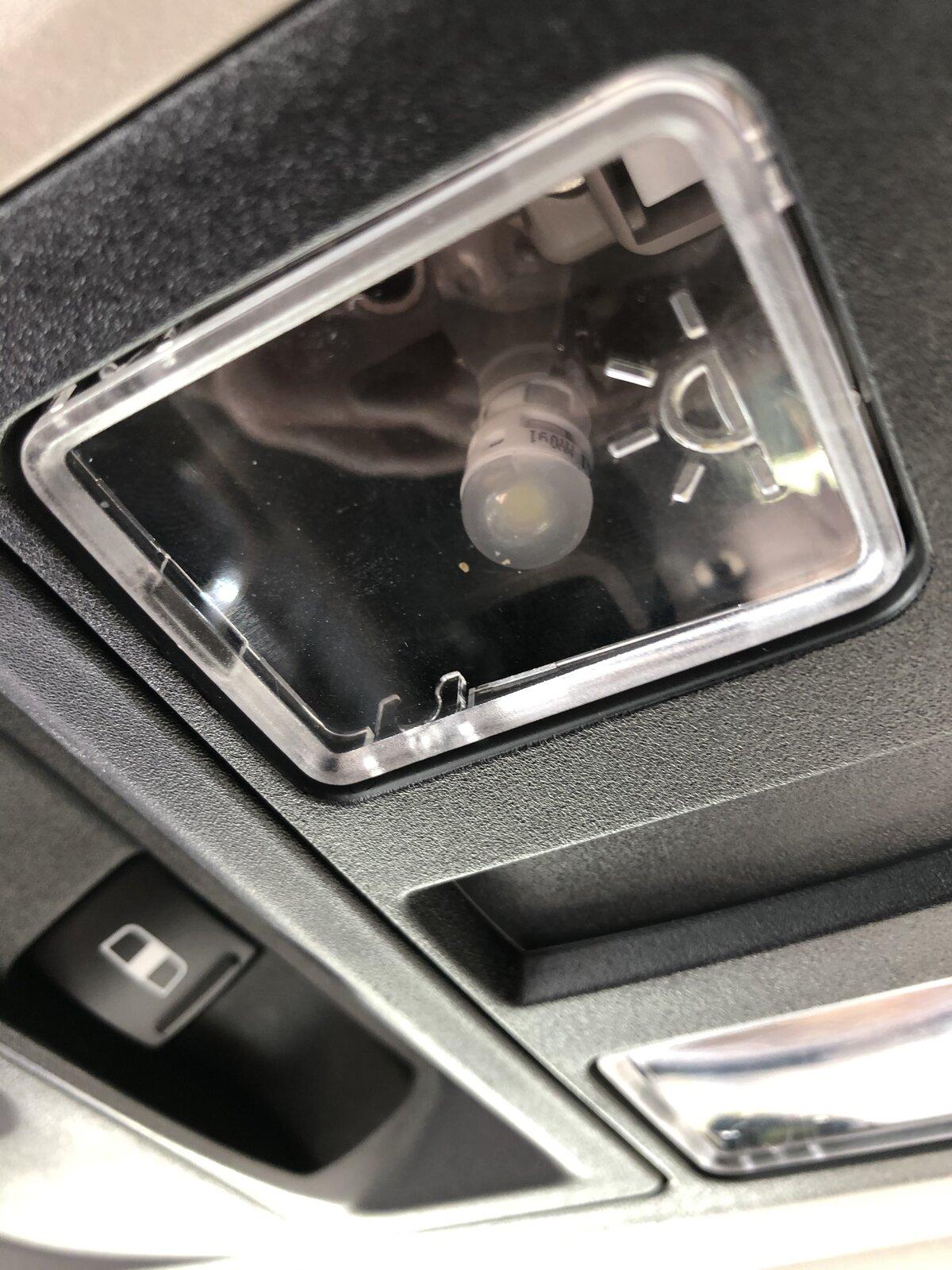

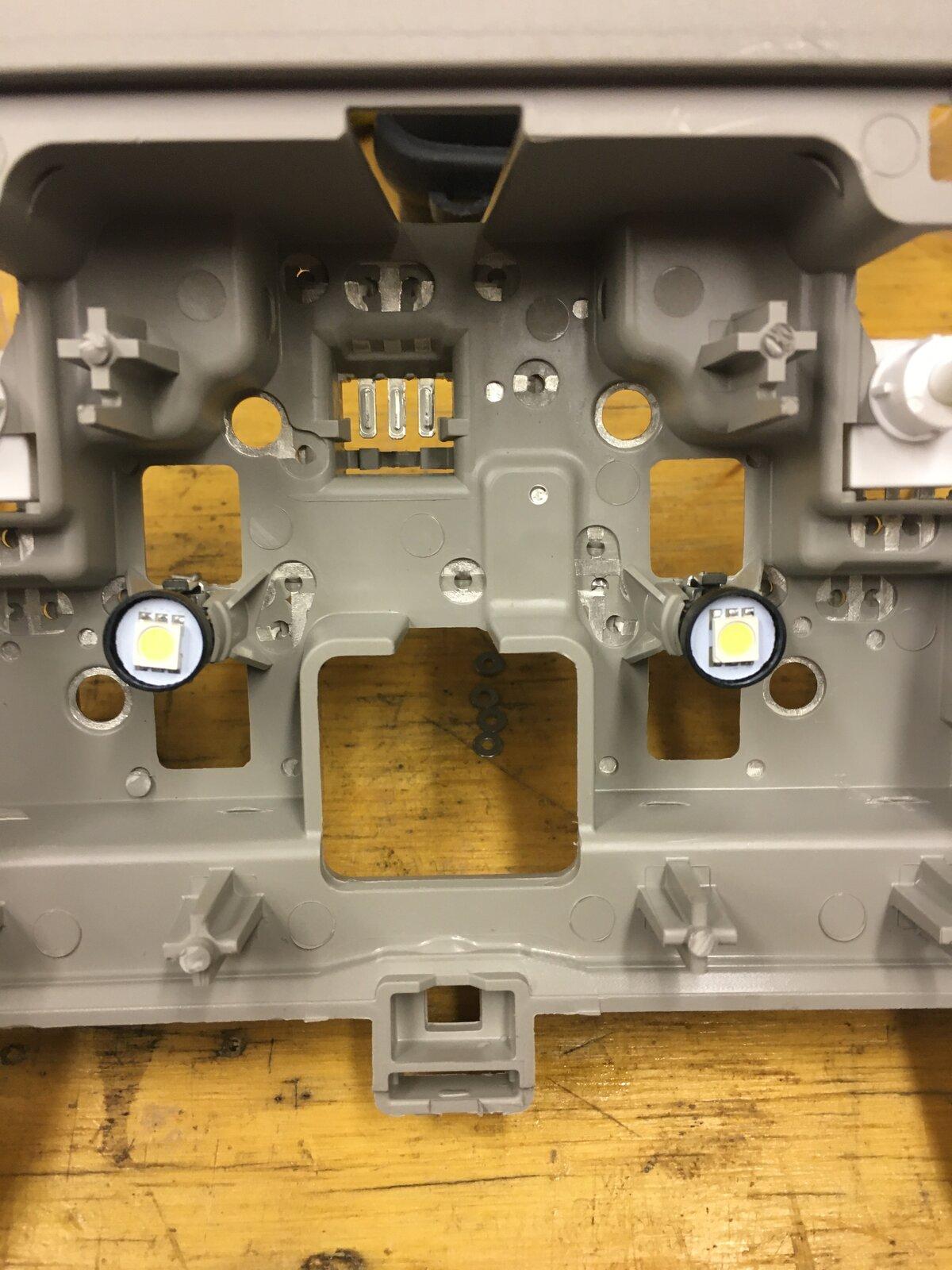

I changed mine out last year. I want to say the replacements are T10s but not sure while writing this. Follow the video above. Now I can change the bulbs by simply popping out the lense. I didn’t replace the entire assembly, just the bulbs. Took about 30 minutes. To get everything out and back together. If you just replace the bulbs, they are led and therefore there is polarity, so if they don’t work, you may have to rotate them 180*.
This is a video on the T-10 Types. You will need the “forward” facing emitters meaning that the light comes out of the end of the bulb, primarily.

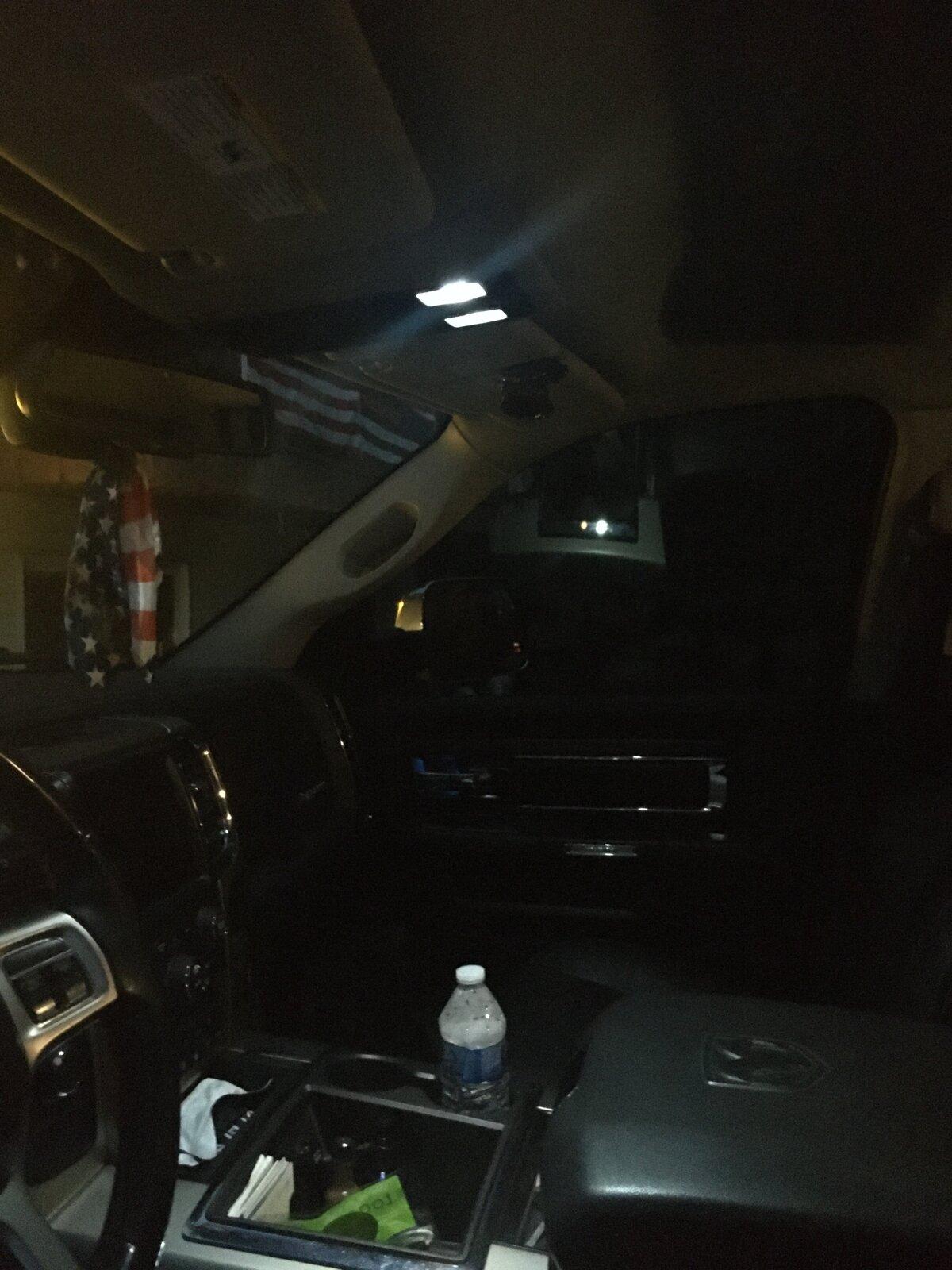

I bought mine from Headlight Revolution. They are are made by GTR. GTR Lighting T10/194/168 CANBUS LED.

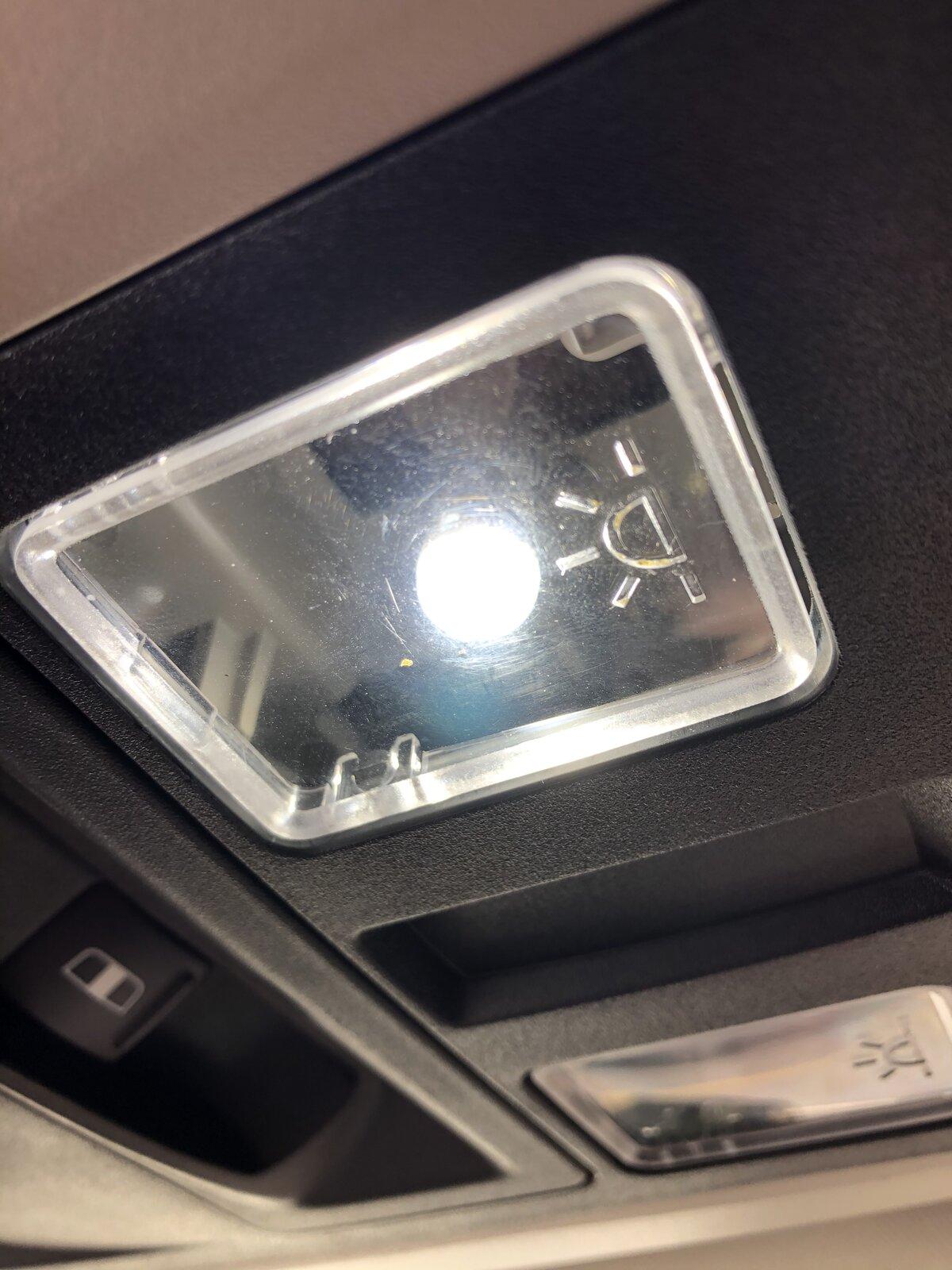

I DONT KNOW IF THE CANBUS requirement is necessary, but, this allows them to dim and come up to brightness slowly. headlight Revolution is expensive and there are better deals out there for sure. I was in a bind. However, the lights I got are great LEDs.
These don’t do the dimming as far as I can tell but they work perfectly for what I was looking for. They had 3 different colors... Amber (194A), cool white (194 in different packaging and about $6 le), and these 6000k bright white (194).
