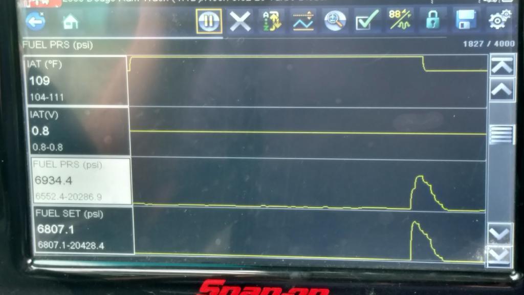

2005 Ram 2500 4x4, auto......267,000 miles. Cranks like a mother but won't start without jimmy juice. Rail pressure cranking is 700-900 psi, waaaay too low. Don't have tools for injector return rate test. Has new fuel rail assembly from Geno's installed with no change in starting performance. Once running, it'll hover around 6700 psi at idle and has rough idle. Cylinder drop test shows even drop on all cylinders. Runs fine at speed.
The strange symptom (besides no fire when cranking which is certainly low rail pressure) is that when the engine is revved up, it'll drop rpm in a stepping down type drop......I'll post a picture of what the Snap-On Solus is showing. Rail pressure graph looks like a set of stairs.......................any idea why the lumpy deceleration? Hopefully it's related to the injectors and it'll be cured with a new set.
Here is a pic of the rail pressure when the engine is revved up slightly and allowed to decelerate to idle.
Injectors are toast. A step down de-rev is a sure sign they are not holding and reacting as the ECU demands. You have to do the de-rev test correctly or the results are inconclusive. If you hold rpm at set point for 10-20 seconds then let all the way off the rpms should drop relatively smoothly on the tach, you might see small steps on a graph but that could be sampling rate.
The no start and low rail pressure is too much bypass in the injector cooling circuit.
The idle speed not dropping is injector (s) mechanically stuck open. The rail pressure stays up by design when you let off the throttle. The sticking injector keeps fueling the cylinder. Not fixing it ASAP can result in melted piston.

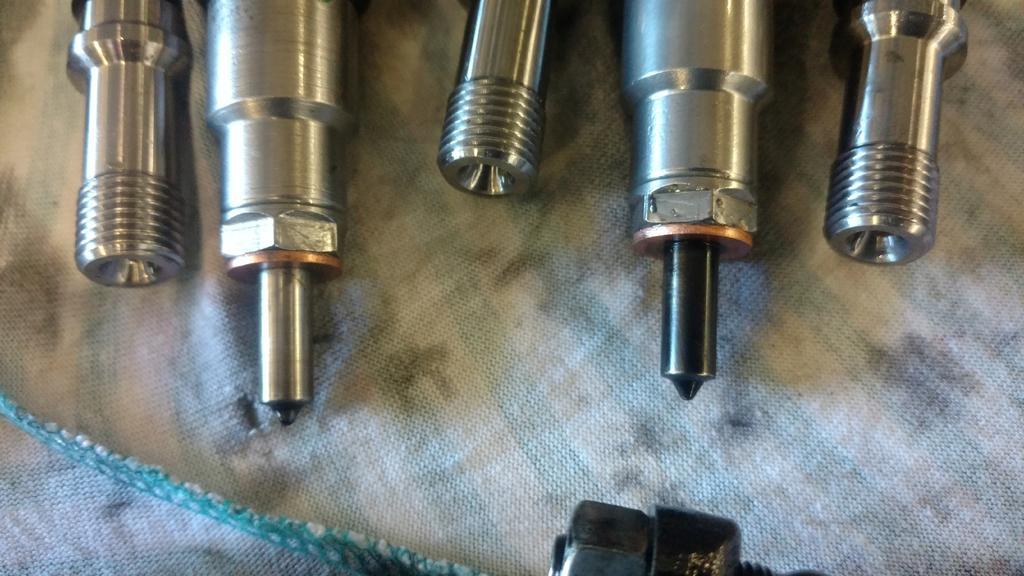

Pulled it down this am.....compression still marginal (at least it didn't drop any and isn't really blown up). One injector has a black tip so I suspect that injector is stuck open causing this God-awful knocking.
Yep, one injector hanging and you will swear it ate a piston and a rod is ready to come out the side of the block. Too much fuel firing at the wrong time and it sounds REALLY bad.
You can say that again! I'm pretty sure it was hanging wide open with the amount of atomized fuel in the exhaust.
