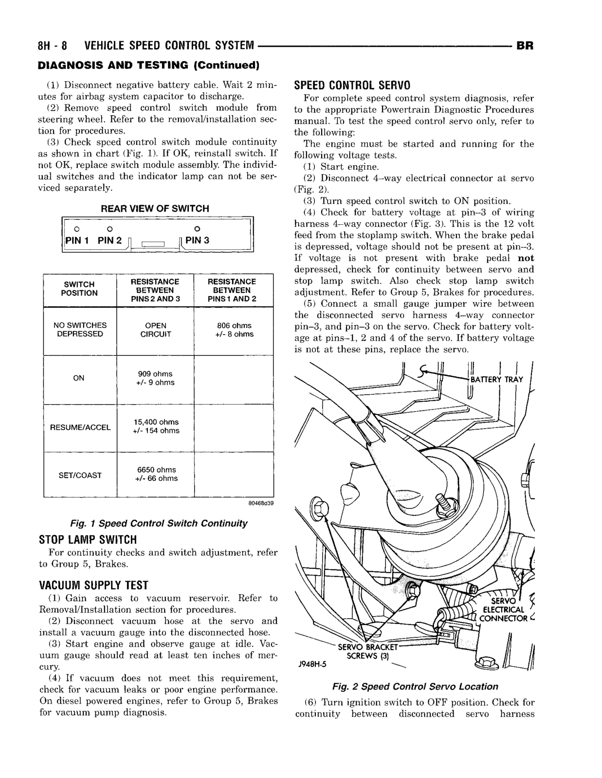

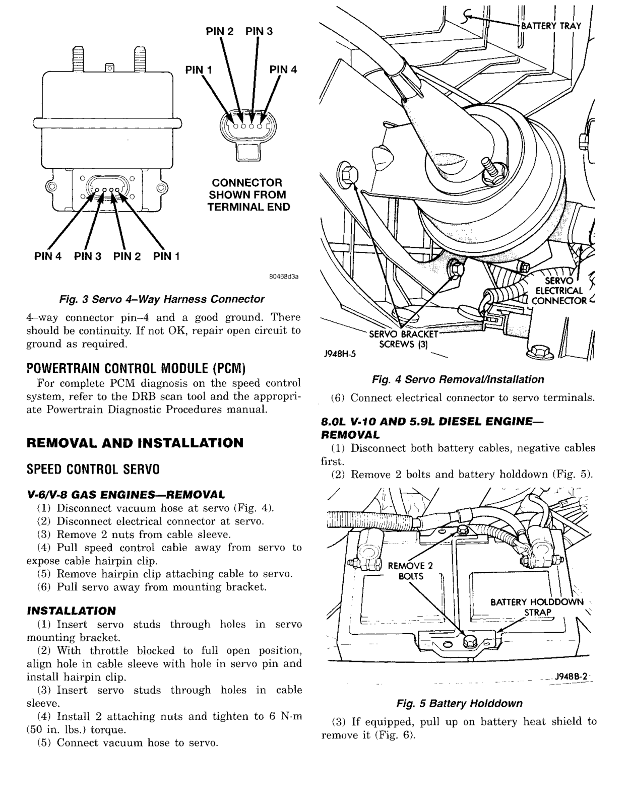

You've owned the truck since new but don't have a FSM? This is from the '96 manual, the only one I have that is digital.
SPEED CONTROL ELECTRICAL TEST
Two different test methods may be used to check
the electronic speed control system. One involves
using the DRB scan tool. If this test method is
desired, refer to the appropriate Powertrain Diagnostic
Procedures service manual.
The other test method will involve the use of a
volt/ohm meter. The volt/ohm meter method is
described within the tests on the following pages.
Refer to Group 8W, Wiring Diagrams for speed control
electrical schematics and connector location.
CAUTION: When test probing for voltage or continuity
at electrical connectors, care must be taken
not to damage connector, terminals or seals. If
these components are damaged, intermittent or
complete system failure may occur.
When electrical connections are removed, corrosion
should be removed from electrical terminals and a
light coating of Mopar Multi-Purpose Grease, or
equivalent, should be applied.
Inspect connectors for damaged terminals. A poor
electrical connection can cause a complete or intermittent
malfunction. For this reason, a poor connection
may be misdiagnosed as a component malfunction.
VEHICLE SPEED SENSOR
For diagnosis and testing of the speed sensor, refer
to the appropriate Powertrain Diagnostic Procedures
service manual.
SPEED CONTROL SWITCH
For complete speed control system diagnosis, refer
manual. To test the speed control switch only, refer to
the following:
WARNING: BEFORE ATTEMPTING TO DIAGNOSE,
REMOVE OR INSTALL ANY AIRBAG SYSTEM OR
RELATED STEERING WHEEL AND STEERING COLUMN
COMPONENTS, YOU MUST FIRST DISCONNECT
AND ISOLATE THE BATTERY NEGATIVE
(GROUND) CABLE. WAIT 2 MINUTES FOR SYSTEM
CAPACITOR TO DISCHARGE BEFORE FURTHER
SYSTEM SERVICE. FAILURE TO DO SO COULD
RESULT IN ACCIDENTAL DEPLOYMENT AND POSSIBLE
PERSONAL INJURY.
SPEED CONTROL DIAGNOSTIC TROUBLE CODES
Diagnostic Trouble
Code
DRB Scan Tool Display Description of Diagnostic Trouble Code
15** No Vehicle Speed Sensor Signal No vehicle distance (speed) sensor signal
detected during road load conditions.
34* Speed Control Solenoid Circuits
An open or shorted condition detected in the
Speed Control vacuum or vent solenoid
circuits.
55* N/A Completion of fault code display on Check
Engine Lamp.
* Check Engine Lamp will not illuminate at all times if this Diagnostic Trouble Code was recorded. Cycle ignition key
as described in manual and observe code flashed by Check Engine Lamp.
** Check Engine Lamp will illuminate during engine operation if this Diagnostic Trouble Code was recorded.

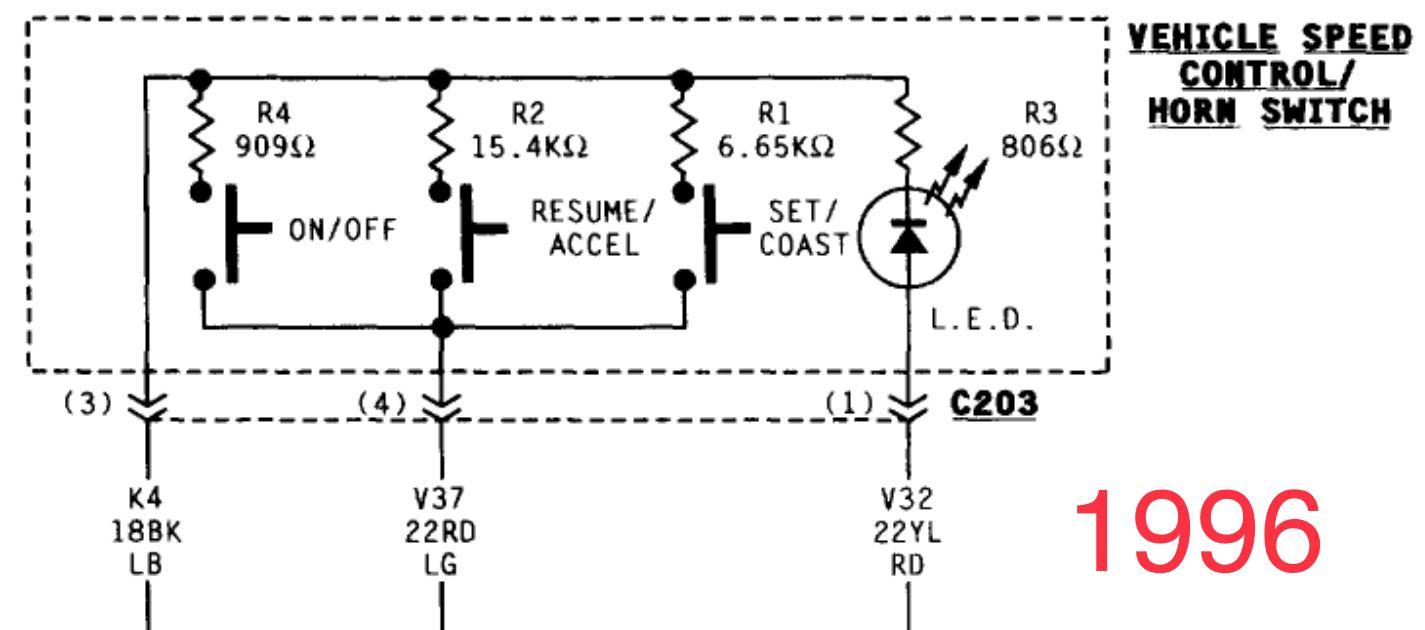

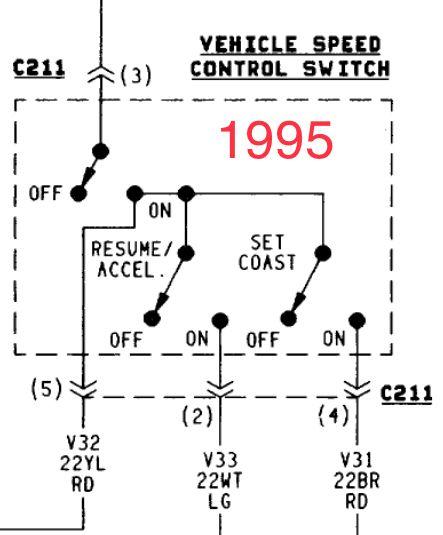

I don’t see how it could work. From what I see, all functions are commanded on one wire on the ‘96 switch by utilizing different resistors for the different commands. The ‘95 switch puts each command on it’s own wire.
BigPapa, my suspicions are in agreement with yours. Particularly since the new '96 only requires 3 wires and the '95 has 4. Now that said, with your superior schematic reading skills, do you see a way the '96 could be made to work?
Thanks for your help.
RonR
Just looking at the differences between the schematics of the two switches I would guess the 96 has a more sophisticated digital switching circuit than the 95. The resistors in the 96 act like a voltage divider and supply the main circuit with discrete voltage values through one wire which activates one of the three circuits, on/off, resume/accel, and set/coast. The 95 uses three separate wires to activate the on/off, resume/accel, and set/coast circuits. It would be a lot easier to replace with the original switch than perform the micro surgery on the 96 switch, hoping the "patient" survives.
