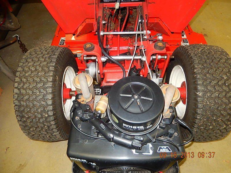

When it came time last month to put put it back onto front line duty I gave it an oil change, a grease job and a new battery. Still had 3 year old gas in it (with Stabil). Hit the key, pulled the choke all the way out in typical Kohler fashion and it lit right off.
Took it down, mowed for an hour before a squeal developed with the PTO engaged. Mule drive idler pulley bearing was bad. Ordered a pair of them, a new mule drive belt and a new runner for the chute side of the deck. Installed it all, even sprung for a new spark plug!!! It is mowing right now.

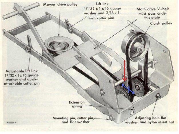

For those of you wondering "What is a Mule Drive?" I have provided a picture. .

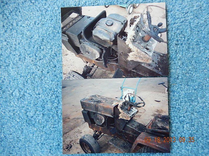

The Craftsman one that the new hubby bought crapped out this summer and had to have a bunch of welding done on the frame and mower supports before it could even be used. This would be it's third summer, HA Ha, should'a kept the Cub around!!!!

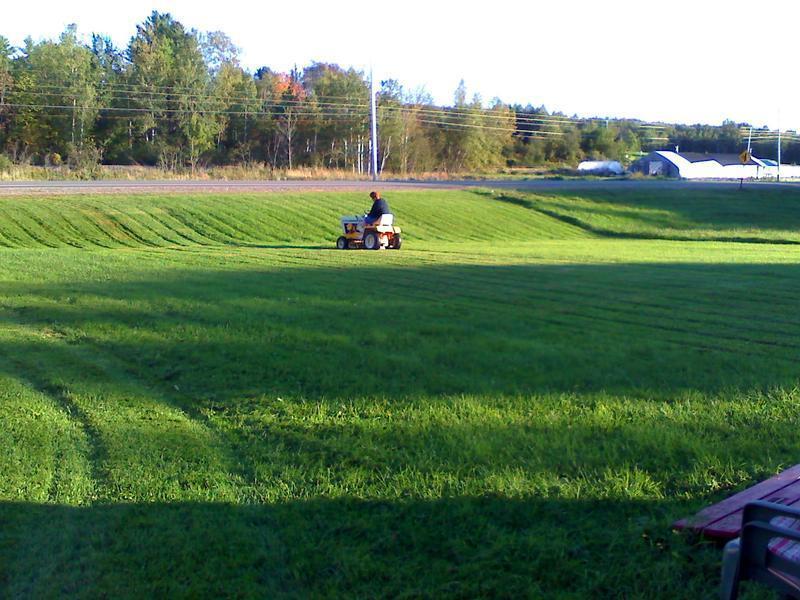

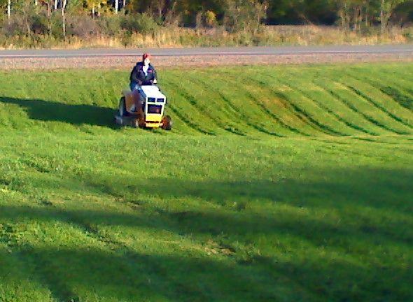

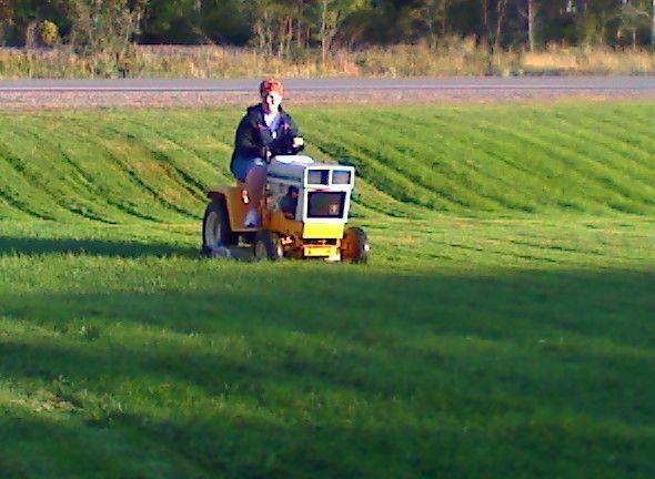

Wife happily mowing away... ..... and that lawn is SOAKING WET, but the Cub don't care.
