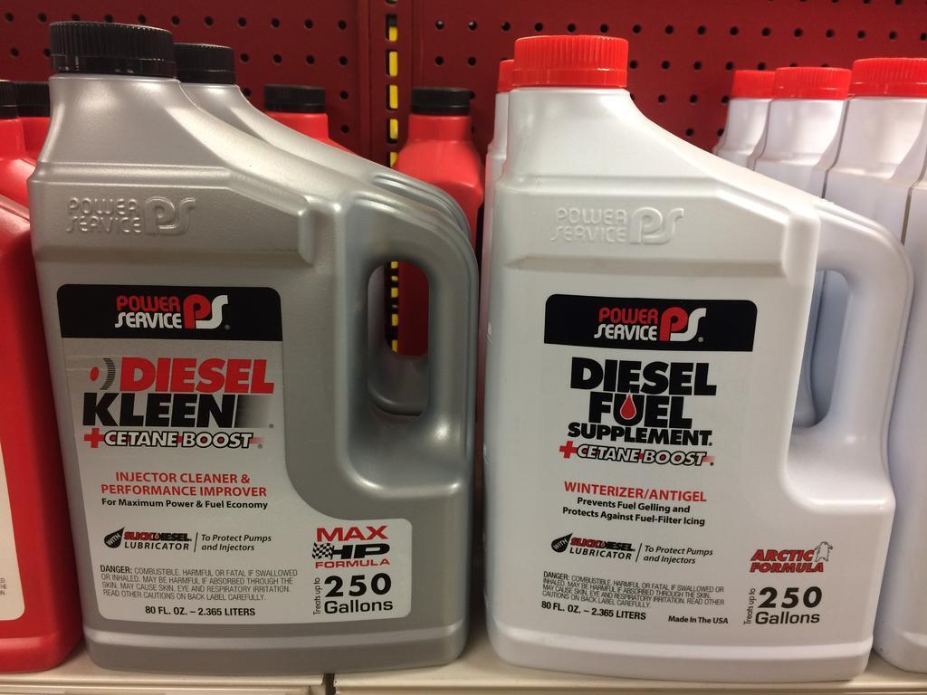

Jeez psp, a little product placement would be nice. I just took a picture out in my
showroom to help the cause....

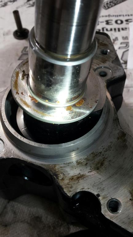

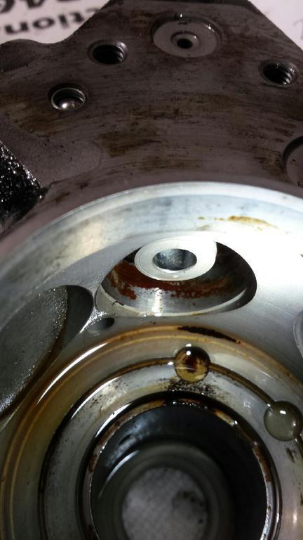

Do to many different blend processes You are much better off contacting your local refinery and contact the lead chemist, I find that these individuals are informative and down right know what the heck the fuel is that leaving its facility, Its tested 1000 of times monthly. Heck if you send them the additive They may test for its properties for Ya. Also additives do have there place in usage but I don't recommended them in most cases..The additive this owner used did not stop this contamination.
You are much better off using the $$$ spent on additive to add bypass filtration system Aqua-zorb filter or one that encapsulates water in fuel, the most talked about systems on the web won't stop future problem in many cases. Water is 100 times more likely to destroy HPCR systems..The picture you see the owner claimed he was running additive.

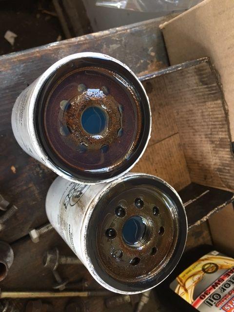

Water separators (Spin-ons) don't work and in many cases cause damage. Now that being said New design on How to separate the water and store are available. Aquau-Zorb (Filters) would be the best ,but are Not legal to install on direct injection filtration system (You would need to install Auxiliary filtration System).
The rusted filters are Airdog filters and the picture needs NO words on how worthless they are (3 weeks old)
