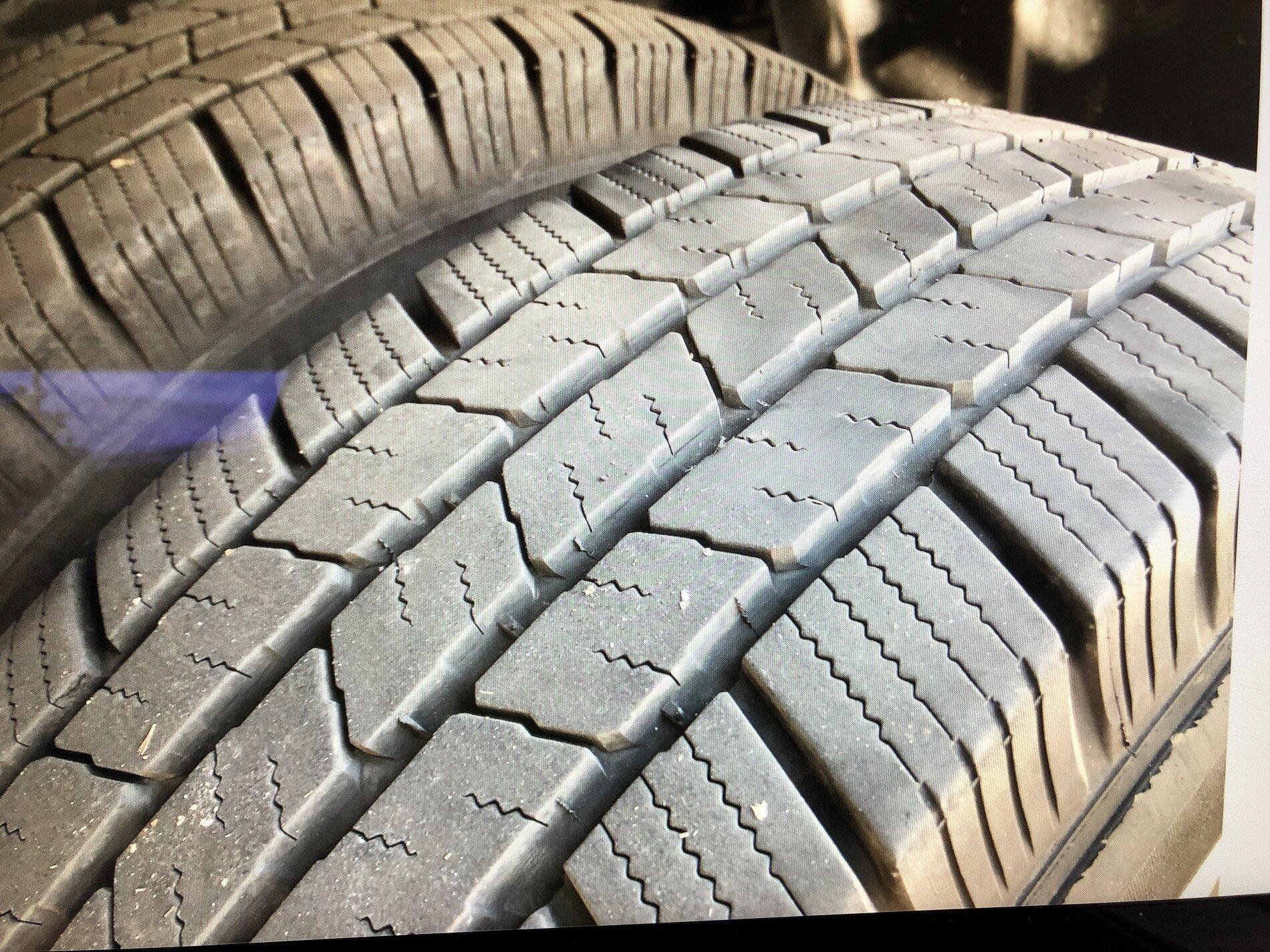

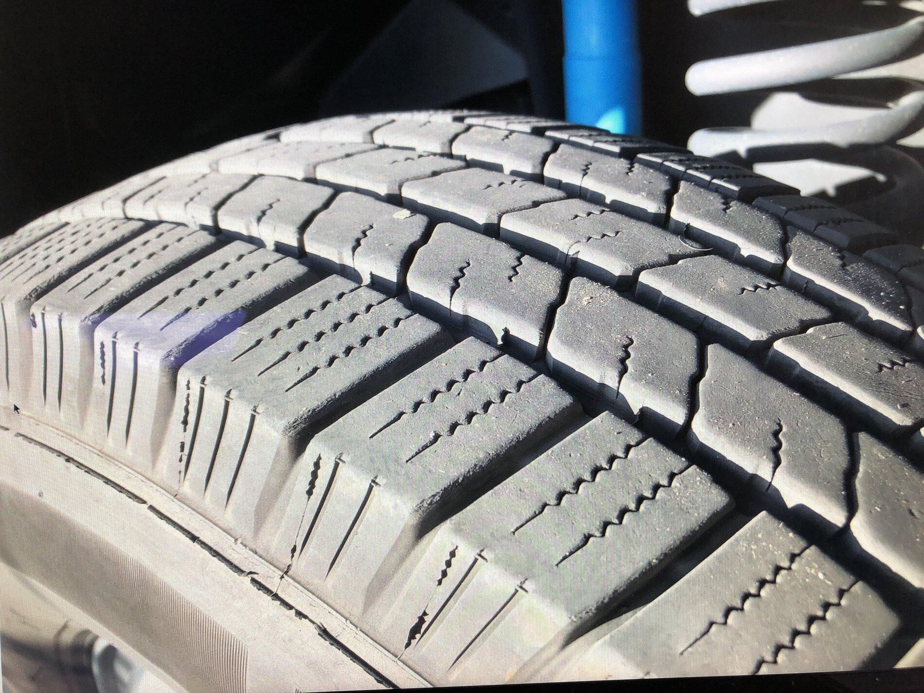

I'm having this issue recently after getting new tires and the web indicates it might be an alignment or worn parts issue. Our truck has just over 20k miles and does not ride rough, noisy or drift when on level ground. Tires are inflated 75-80psi. In the pix, it is more severe than is showing on my tires but is like each step has its own ledge very slightly. Only on the outside and more pronounced on the drivers side.
Take it to a QUALITY alignment shop and have them set the toe to 1/64". Stock setting is 1/4" and causes outer edge "Stepping".

Okay. Set toe to 1/64". Thanks Cummins12V98. Knew you would know. I had Discount Tire replace the original Nexen tires that were separating at 20k miles and had asked them about the cupping. They told me to take it to a "quality" alignment shop that did heavy trucks. None of the DT in the Conroe area do alignments. I'll get this done pronto. Here's mine.

cupping is zero to do with alignment. First is tire quality/construction, next is balancing (inc good pressure) , and last is front-end integrity (or the lack of). The very outside cause is a bad load distribution across the four tires, but that's an outlier. Bad alignment can cause a lot of things, but cupping isn't one of them unless its so far off you can't keep the truck pointed straight down the road without two hands. I was in this business during a previous life
Too much toe in will cause the cupping / feathering you are showing. I’m running 1/32” toe in on my 2013. Since I’ve set things up I show almost equal feathering on both inside and outside of the front tires. Steering wheels will wear the outside edges. One of the reasons why you want to rotate fronts to back every 10k miles.
