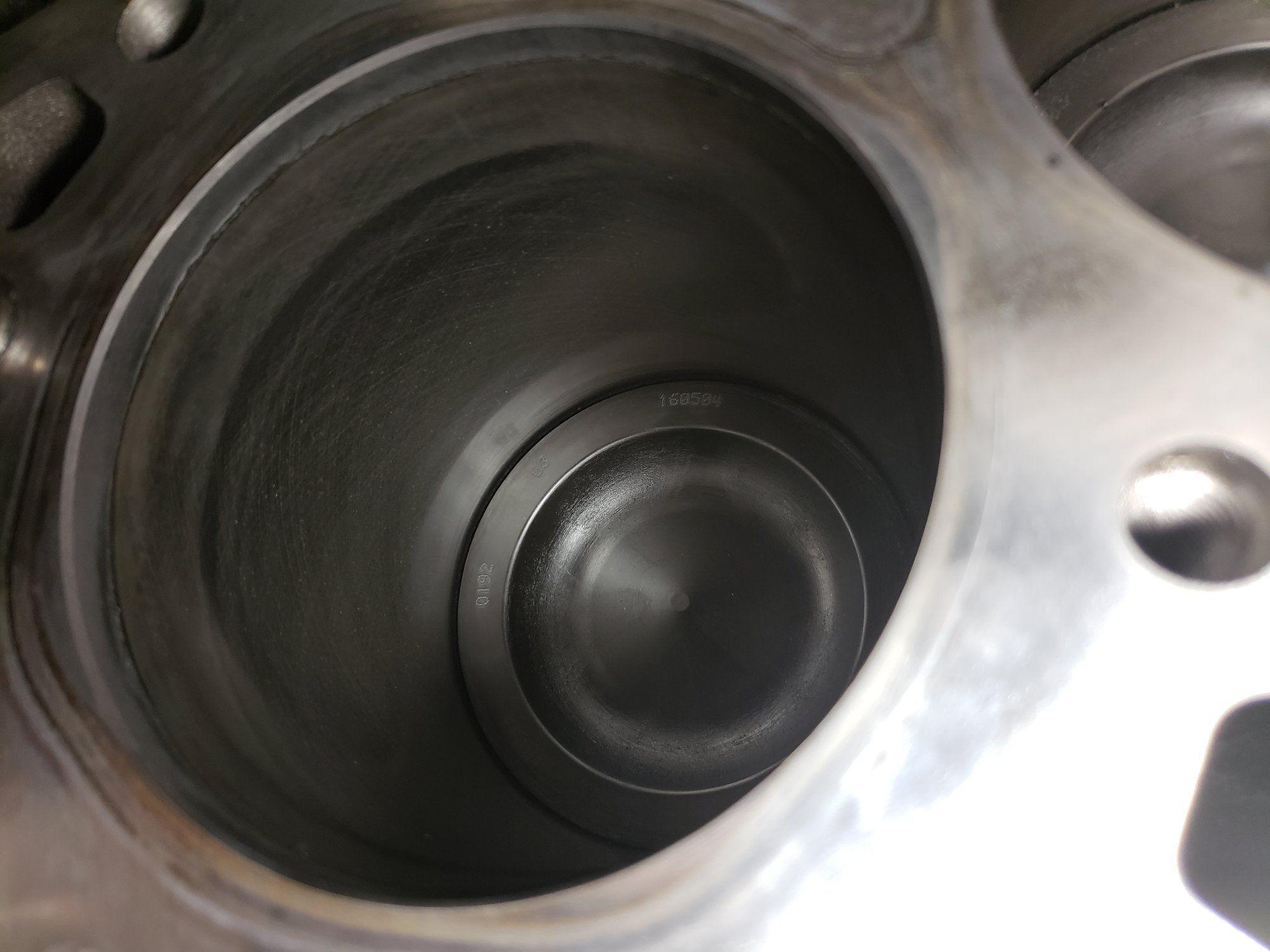

Well, the head is off and all cyls and pistons are in perfect shape. That's a relief.
