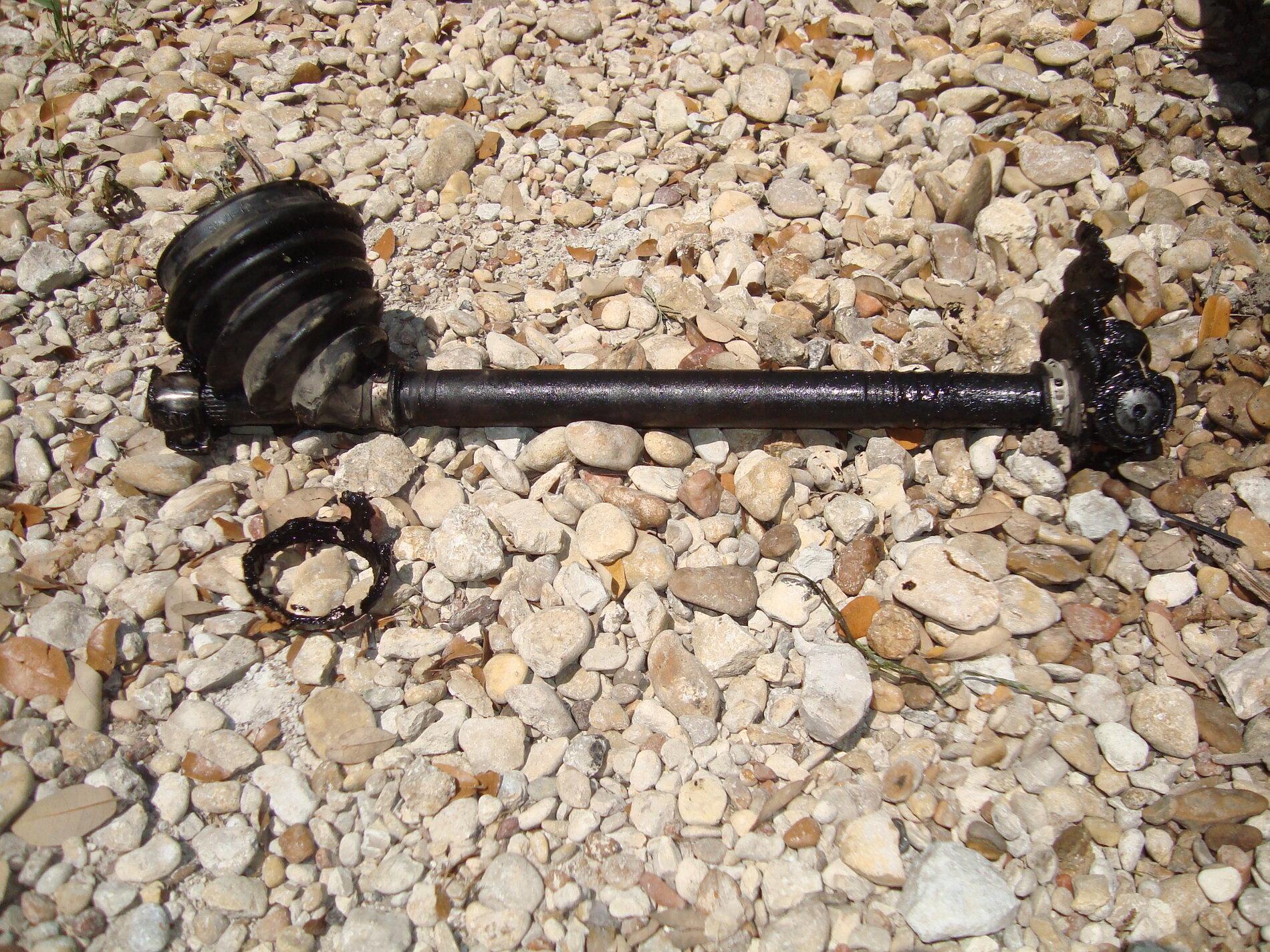

This is what came out. The little circle is part of the bearing cage from that end of the axle. The rest of the cage and the ball bearings are on my workbench.

Mystery solved. I got under there with a ruler and a straight edge. The lower control arm, sort of an I-beam looking thing, is bent forward about an inch at the outer mounting bolt. The strut has a wishbone that goes over the axle and bolts to the control arm, it is twisted. Maybe it will twist back once disconnected from the lower arm, don't know. The tire on that side was forced up and to the max stop at the spindle bracket base. Something had to give, so it was the lower arm. The spindle bracket quit turning when the tire hit the inner fender. Sure hope his Covid unemployment check comes through.
