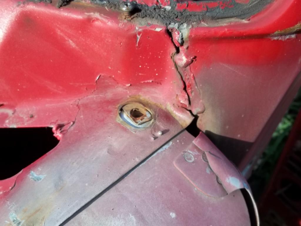

Were the water is coming from is the cowling .
Because it cracked and typically the drivers side cracks more than the passenger side. Its a design flaw and there has been discussion on the reason they break because of tire balance etc.. However it is still a design flaw . The metal gets paper thin in areas during the manufacturing process , the fix is pull the fenders off and either weld or soder it back up or it suppose you could fiber glass patch bit up and still could be a good idea . On my crew cab im building , i welded it up hoping it holds , its not easy because its super thin , i them applied several coats of flex seal and i may add some flex seal tape before the front end goes back on .

Just below the corners of the windshield.
Now, that said, my '92 has the front roof corners rusted out and it leaks profusely.
