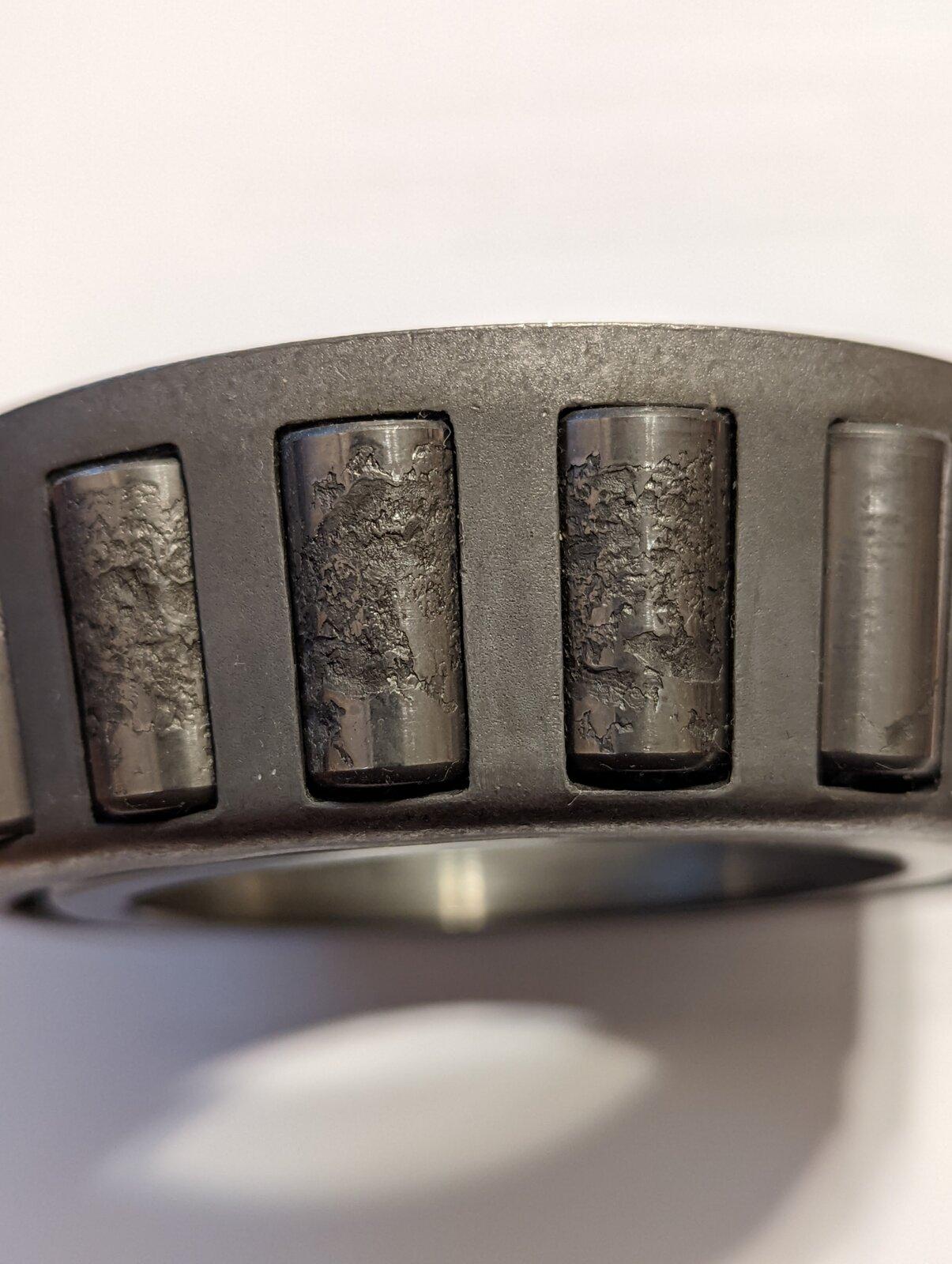

Had the gearboxes all drained and filled last week, all visually looked good except the Dana 80. Lots of metal on magnet and oil looked very nasty. Running Schaffer 75w-140 full synthetic. Only about 22K miles (three years) with both axles and transmission, transfer case only about 7500 miles, but I wanted them all on same schedule. I run around 8000 pounds all the time but never over about 13k GCVW.
I have had nasty oil almost every time out of the rear axle, including IIRC the OEM fill and then Amsoil for a while and now the Schaffer. Been trying to keep rear axle change at 30-50k, nasty oil at 22k seems to indicate a tear down.
Truck has 320K, I am original owner and the rear axle was rebuilt once about 100K ago, additionally have had at least one wheel bearing replaced and a pinion seal + wheel seals since that rebuild. I notice the pinion seal is shot again too.
This Dana 80 seems to be the anomaly, but mine has give more issues than any other mechanical issue on the truck.
I am going to have a local shop tear into it again or optionally drive 300 miles to Randy's
I am thinking there may be something inherently wrong with my axle from the factory and thus consideration of a specialty shop taking a crack at it.
FYI, Torque King recommends about 125k-150k as bearing intervals on the Dana 80. Apparently the Cummins hammers them out and I expect mine has beat out bearings. Attached is a photo of one of my OEM center carrier bearings that was replaced at the 1st rebuild about 100k miles ago. PXL_20220110_194638779.jpg

222462 replaced at least center section side bearings (basically entire rear axle apart, not sure what else was replaced) photo of one of those bearings in initial post

Seems like a lot of issues for a fairly lightly loaded dana 80! never been over about 13k truck and trailer. I am thinking maybe initial failure had a lot of metal that wasn't removed and replacement seals and bearing are continuing to get wiped out due to wear metals or destroyed surfaces.
I don’t see where the pinion bearings were replaced. Usually they’re the first to go. With all the other bearings being replaced, the looks of that carrier bearing, and no mention of replacing the gears, I’d say you need a good FULL rebuild, ALL bearings AND gears. All that metal from those bearings and races has had to eat those gears. Proper setup, which is an art, is the key. The lube you’ve used isn’t your problem.
I tend to agree. They might of done the pinion bearings and wheel ends at time of "rebuild" about 100k ago, BUT my notes only mention carrier bearings, would need to go to file cabinet and dig to find out what all was done. I know for a fact no gears were replaced. There has been a howl at 45 mph since they had it apart for those carrier bearings, so assuredly didn't get the gears quite right, but I do understand hard to do on used gears.

Thats part of the problem. The Dana open carriers are soft, too much cast iron. The torque side, next to the ring gear, will beat the bearing loose on the carrier. When that happens the bearing can move, now it spits out the thin shims. Then the ring and pinion grind them up, now you have metal all over and bearings all get eaten alive.
The LSD carrier has more steel in it and they don't come loose. At least I have not ever seen one come loose. But opens, lots of them. I always make sure the thin shims are between the thick shims for durability. Keep them (thin shims) away from the bearing or carrier.

Got truck back from shop today. The carrier side bearings were toast again same as 100k ago. Replaced all bearings and seals, but no gears, those all looked OK. It appears that the whine at 45 MPH from the last shop 100K ago is gone. Also replaced the driveline center carrier bearing because I had a speed vibration, it seems gone too, but likely won't last 300k, NAPA's best made in China.
