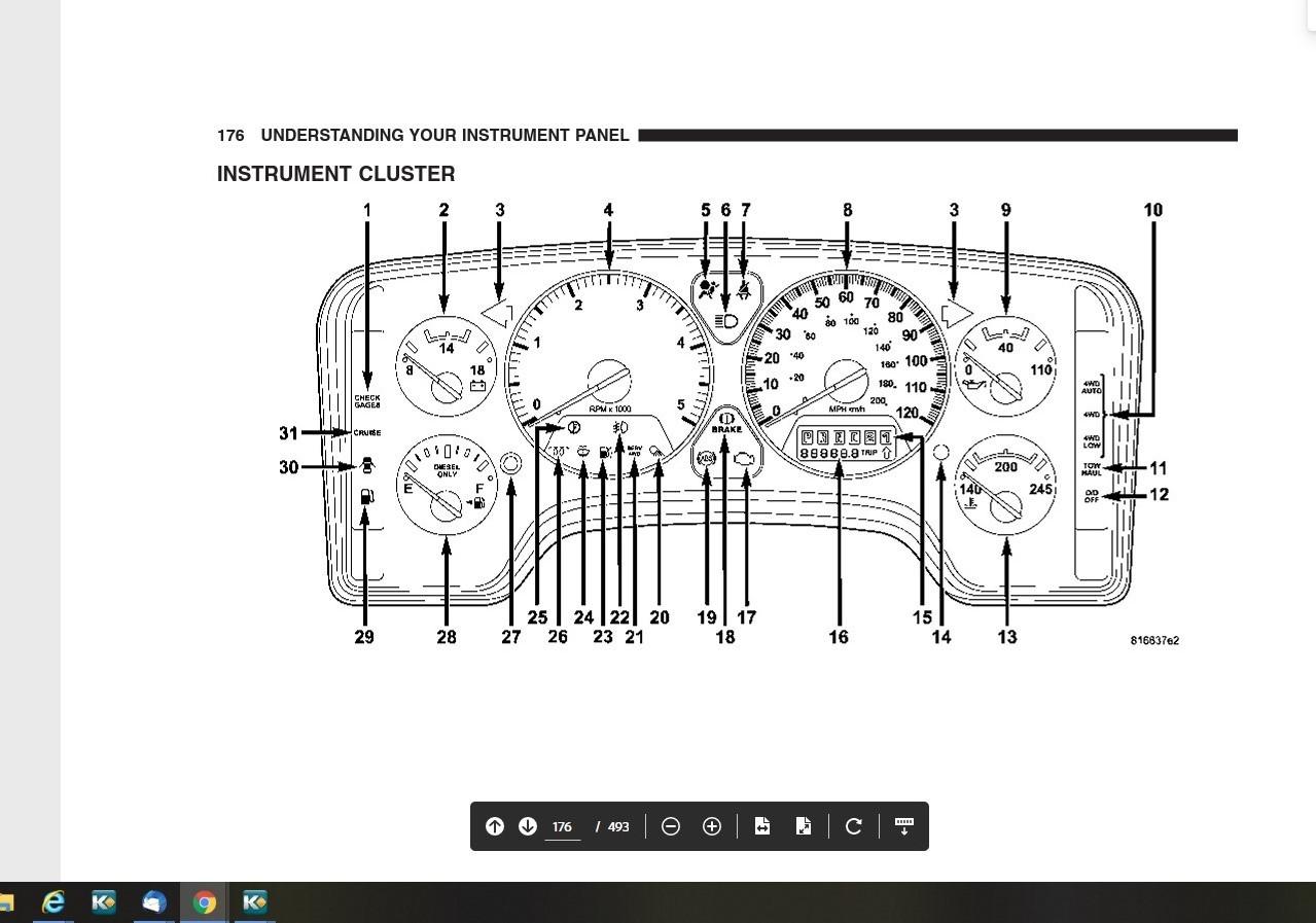

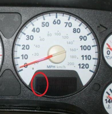

I noticed it illuminated a couple of time the other day... I thought the upshift arrow was to the right of the 1st gear indicator, the one I see is nest to the Park indicator... Mine is an 2006 Ram 2500 with automatic... Thank you...
You got me, I just checked the owner's manual and no joy..

If it's below the P then that's the unused upshift arrow.
I believe it was off to the right on the 03-05 cluster (which is shown in the 06 manual, but the 07 manual has the correct cluster).
I just checked my '06, the up arrow is directly underneath the park indicator. I've never seen it illuminated but I wouldn't expect it to with an automatic.
