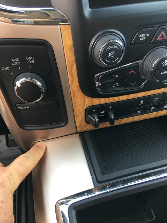

Press here -- if the rattle goes away (like mine did), put a little pure silicone lubricant on something like a very thin rag and get some into the incredibly small gap there. Those teo pieces of plastic in very close proximity make what sounds like a dash rattle in mine.
