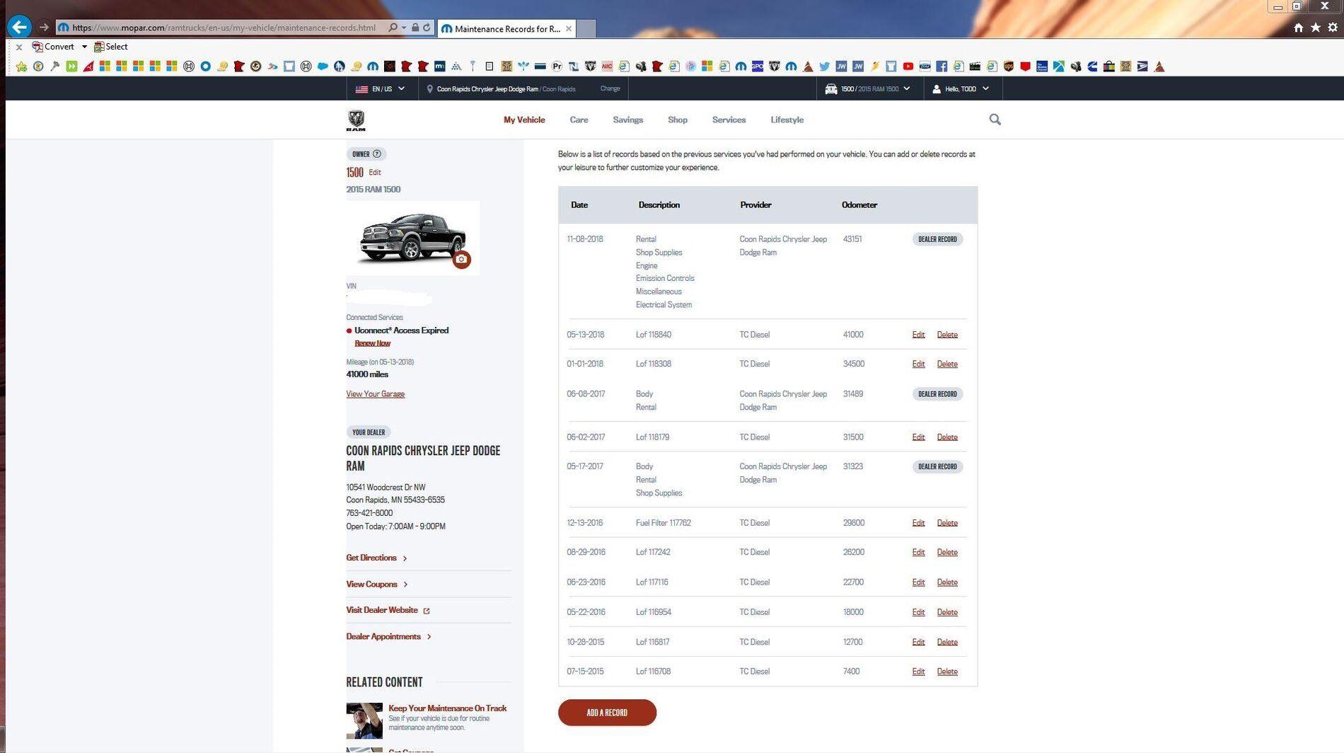

The OP example that owners of the 3.0 Should be doing OAs... its extremely difficult for FCA to deny warranty if the OAs show no sign of failing or if it does shows high levels of wear and it indicates the owner was doing proper maintenance
You should also post your service records at mopar.com
