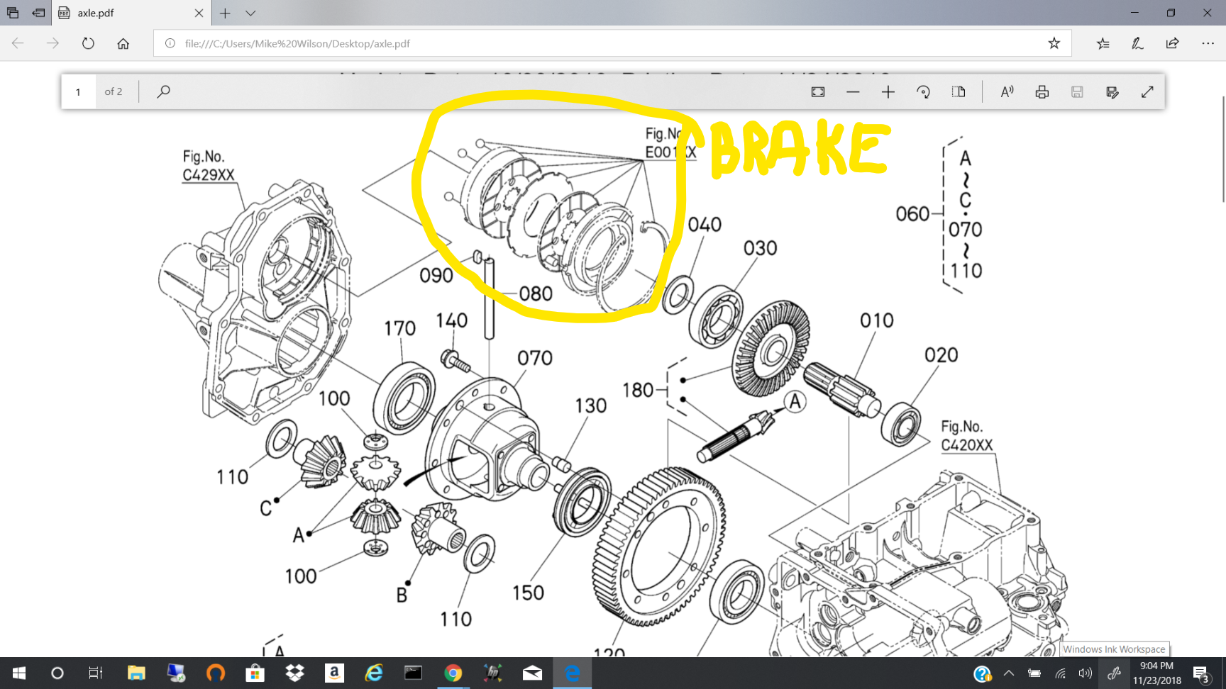

I don't see a significant difference. One thing I don't see spelled out, and I may have missed it, is whether they have planetary final drives or bull gears. For mowing it's not a big deal, but for loader work, and ground engaging implements, planetaries will hold up better. Bull gears tend to deflect and knock out seals.
I'm almost positive that I read somewhere that the Deere is bull gear.
Being a parts guy I went into the Kubota Parts Book library. Both my B7500 and the BX1880 have a bull gear type drive in the rear axle...no planetaries....

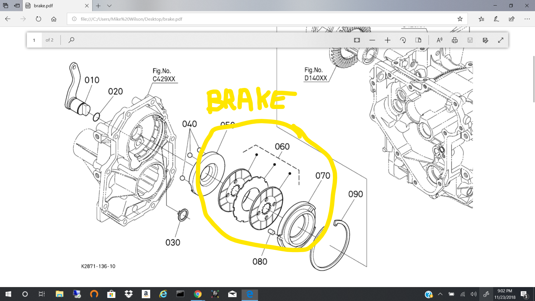

I’ve only seen wet brakes with planetaries. I wonder what the setup is? Also I’d think that planetary axles will drive up build cost fast!
I would think where you already have bigger stuff around that a used one with a mower deck only would fit the bill. I'm sure in your area there are some low hour gentleman farmer rigs around. Used machine, less emissions issues.
One thing that sold me on mine was the dirt simple design, glow plugs are activated by holding key between run and start. Pull a lever to shut it off... After chasing emissions crap for truck diesels all day long I want to come home to simple...
Oh wait, my wife does that already......;)
I'm here for you Wayne.....
