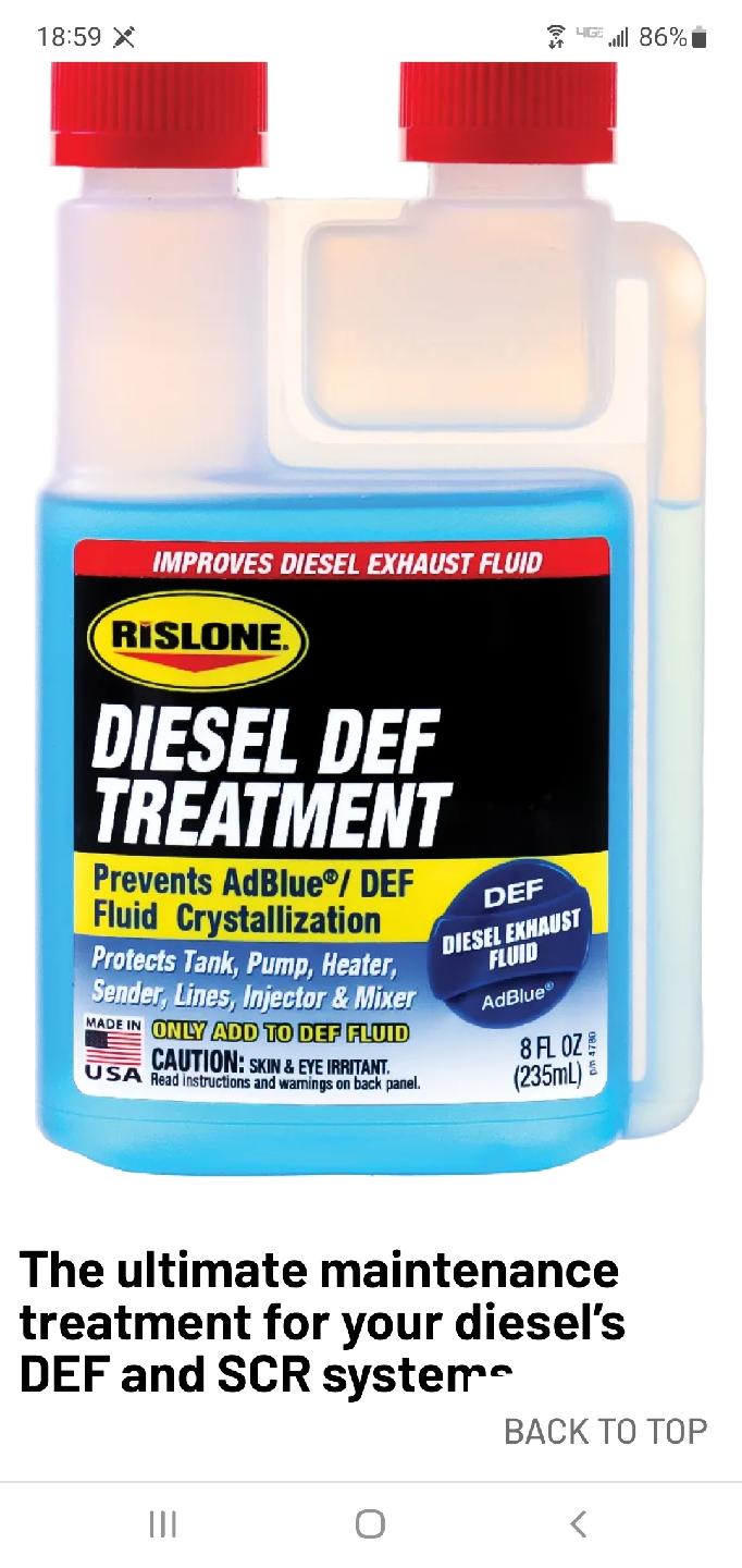

My buddy in NC asked me a question the other day if I used a DEF additive. He is not a diesel owner. That being said I didn't know there was an additive for DEF. Is anyone using such a product? Here is the picture of a additive that he text me.

I wonder if the Rislone additive is the same as the Blue Platinum's additive which they claim is proprietary. There are a lot of reports of the Platinum keeping the injector clean. There are tons of clogged injector problems and reports, maybe Rislone is good to use.
No it isn't the same as the platinum is totally standard DEF according to the stringent standards that do not allow to ad anything aside from what's mandatory, we discussed that before.
The Rislone is a add on, which I'm unsure it is legal to use by EPA standards as by law you are responsible to use straight DEF only in your road going vehicle.
For example it would definitely be illegal to sell DEF with the Rislone already in it as it wouldn't be within the standard anymore.
The only standard for DEf that I'm aware of is 32.% Uerea How then does Rilone change the standard? Adding the Rislone doesn't change the %Urea. By the way, DEF specs are ISO, not EPA.
Just based on 11.8fl oz in the tank that isn’t DEF the concentration does change, down to 30.8% on a 5.7 gallon tank. That alone changes the standard.
Not saying it’s bad, just pointing out that it does change it. That’s nowhere near the threshold for a CEL thou.
As usual, you make a good point.
Noteworthy: I read reviews on both of Rislone's DEF additives. Many said that they had DEF contamination probems soon after adding it.
Correct, and the other 68% have to be destilled/deionized water. And nothing else is allowed to the standard. That's the rule. And no manufacturer that wants to label it DEF and sell it can change anything to this formula. There is no DEF better then the other.
We had this conversation before.
I agree, DEF is DEF. However, Old World Industries describes their Platinum as "BlueDEF Platinum is a mixture of high purity synthetic urea, deionized water and a proprietary formulation featuring new Advanced System Shield technology," Contrary to what you say, adding a proprietary formulation to the standard or "change anything to this formula" seems to be allowed. If so, I would think Rislone products are legitimate as well.

In the Forum "we" discussed that topic of the magic DEF that doesn't exist.
The SDS for the Platinum doesn't list any other ingredients then the urea and water, if they would exist they would need to be mentioned in the SDS by law.
If it comes to the Rislone then it's up to you if you want to use it or not, as you are the one that is creating the (illegal) mixture in your DEF tank and you're responsibility for it.
Like said, as a mixture it would be strictly illegal to sell it to the public and advertise it as DEF as it has components in it that aren't supposed or allowed in DEF.
(I've read the Rislone SDS as well)
Again, feel free to use it, I just point out the situation from the point of the law.

It still baffles me how Platinum advertises its performance over regular DEF when there's nothing to show what makes it different.
I have no intention of using Rislone or any DEF additive.
