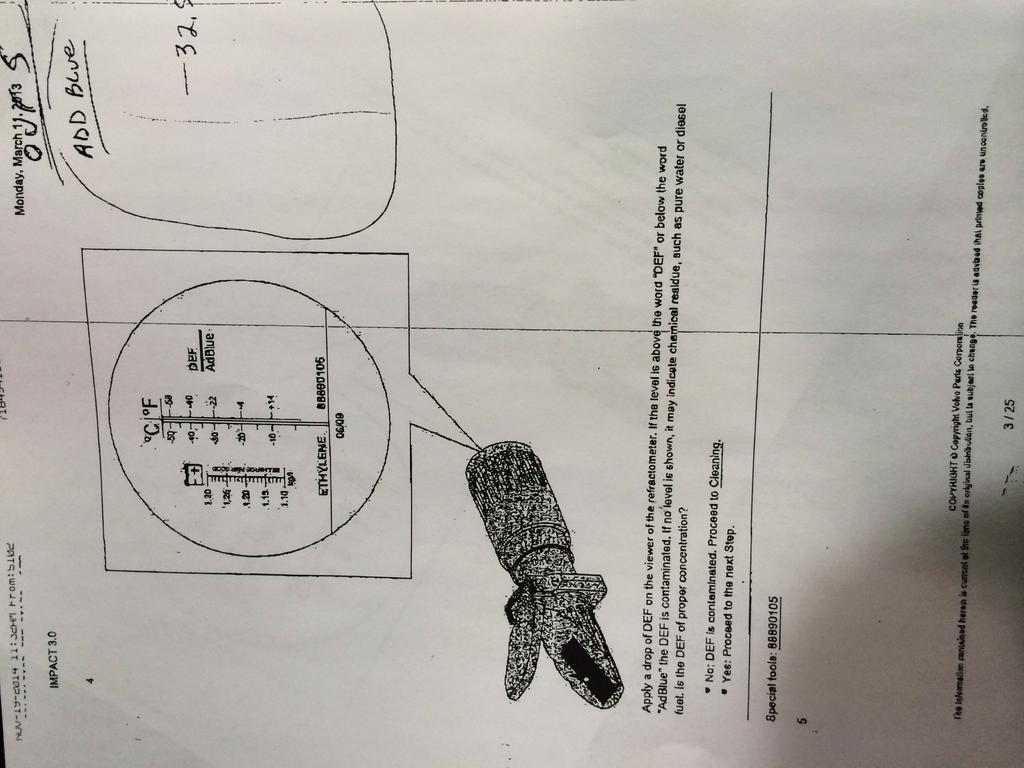

It's a big issue. DEF contamination. Today I was shown a refractometer that shows DEF purity. Works the same as the refractometer for coolant. Here's the wiki on what it is for those not in the know. This is a handy tool for someone who owns or operates equipment using DEF.
I have an image of the instruction page which I will post later. I thought it was interesting to see, and it works well. Our sample was in range.
That's a good point Bob. What mixes well with DEF that couldn't be detected otherwise? My one time with DEF contamination had the fluid milky white, but a thorough flush, filter screen change and commanded pump run saved us that time.
Here's the instruction sheet for all curious.
Bob, upon rereading the sheet, it could detect impurities such as diesel fuel. But I guess this plus test strips is the total package. What strips do you use?
