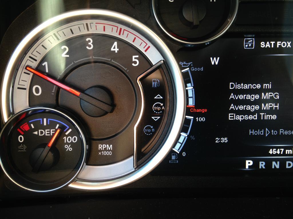

Here's a gauge pic today at 4547 miles. I don't have any mileage figures yet but it looks Ok so far.
