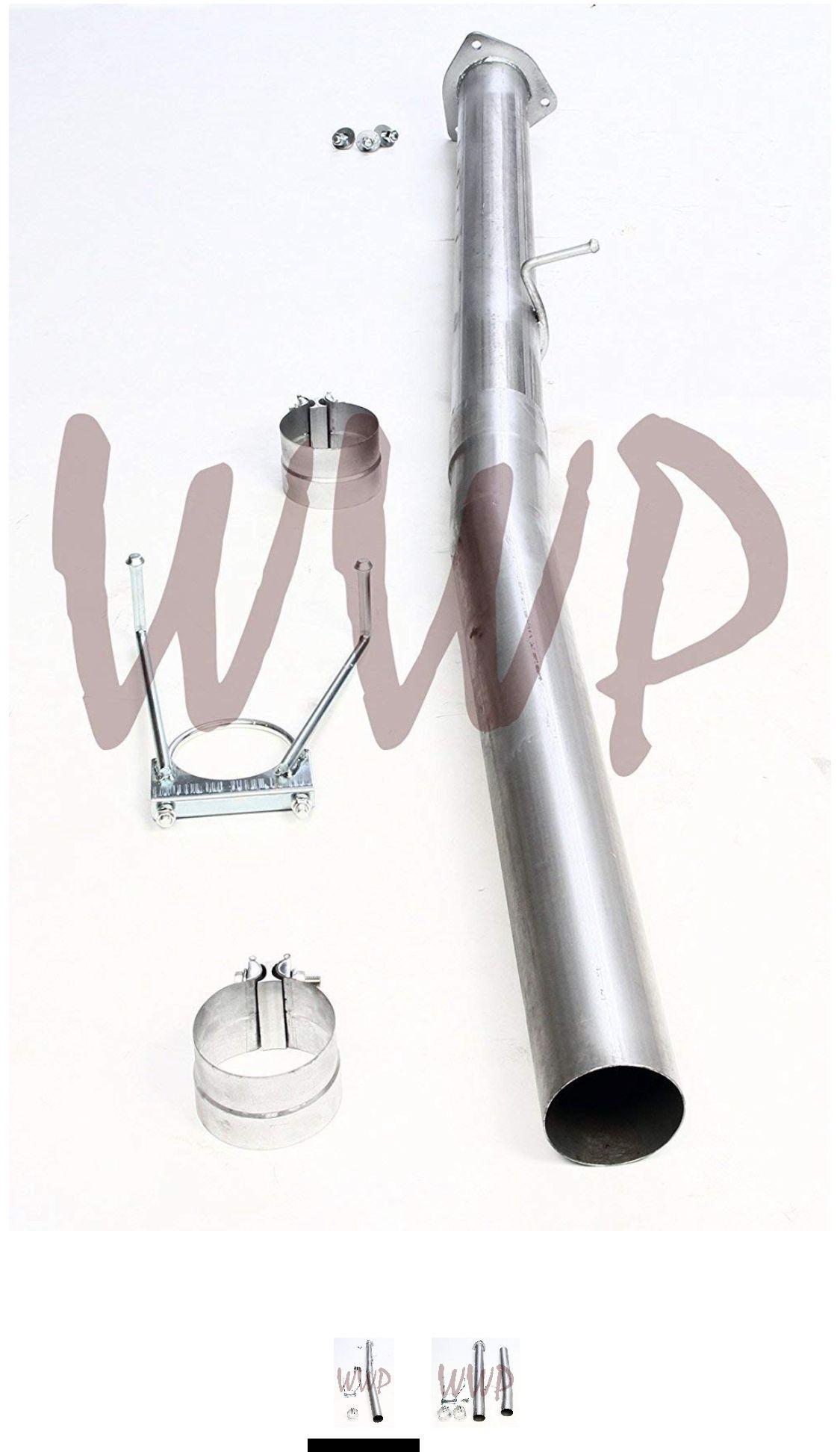

- How difficult is it to remove the exhaust after the turbo?
- I ordered a 4” delete pipe that eliminates the cat and DPF. Any special tools or techniques?
- About how long should it take on my back in my garage with hand tools and beer?
I’m very mechanical with a plethora of tools, I just want some advice from you pro’s out there in Cummins land as this is the first diesel mod for me.

I can't speak for your truck! But on my 2008, this took about 4 hours to do the delete on a rack. Why? You need to remove the sensors for the exhaust tie them off and protect them from the elements and hot exhaust temps. We than had to loosen the transmission support bracket, if I remember correctly to move the exhaust pipe out of this area. We drop the rear spare and had to move this over to clear the exhaust pipe. It is very difficult to access the bolts at the rear of the turbo to the exhaust pipe and this took some time in getting the clamp and bolts align correctly to secure the exhaust pipe to the turbo.
You have a lot more to remove so, plan on a very long day to do this and maybe into the next day also. Good luck!

I’m not doing 5”, so the factory down pipe stays, and I’m keeping the factory rear section of the pipe, basically it connects to wherever there is a 3bolt flange.
This is what I bought.
it probably wouldnt hurt to spray some pb blaster on the bolts for the exhaust just to help loosen them. Yes you only have 6k miles but that's still a lot of heating and cooling cycles on the hardware and road exposure so they could stiffen up.
if your pulling the down pipe i just used a sawzall so i didn't have to drop the cross member and welded the down pipe back together and sold it. Make sure that you install the tuning first before you start pulling parts that way if you have an issue you aren't dead in the water if you need to wait for a re tune or changes.
Other advice i can give is that Shibby engineering used to make dummy plug connectors for the sensors and plugs that are removed during deleting. I ordered some for 75$ back in 2014 and they have worked great and I have had any issues in them.
I would spray all the bolts the night before with WD40 or penetrating oil, then it has all night to sit and work its magic. Your truck is pretty new so you "shouldnt" have any real issues with stuck hardware but it only takes one to throw an easy job off the rails and severely increase time, cussing and consumption.
