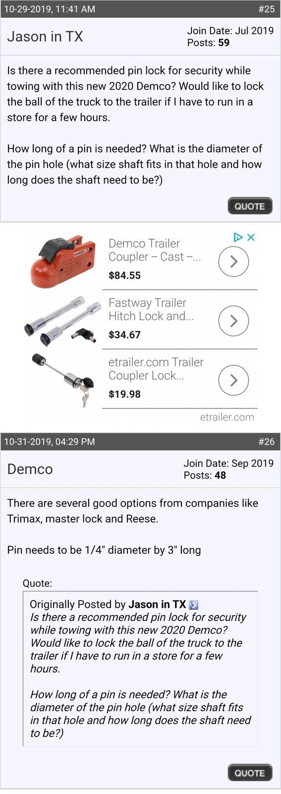

Demco was very active in answering this on Airforums and I think the lock question came up too.
click on link Demco addresses question
How to lock Demco Coupler?

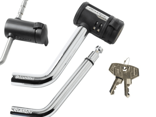

something like this ???
Looks like 1/4" only.

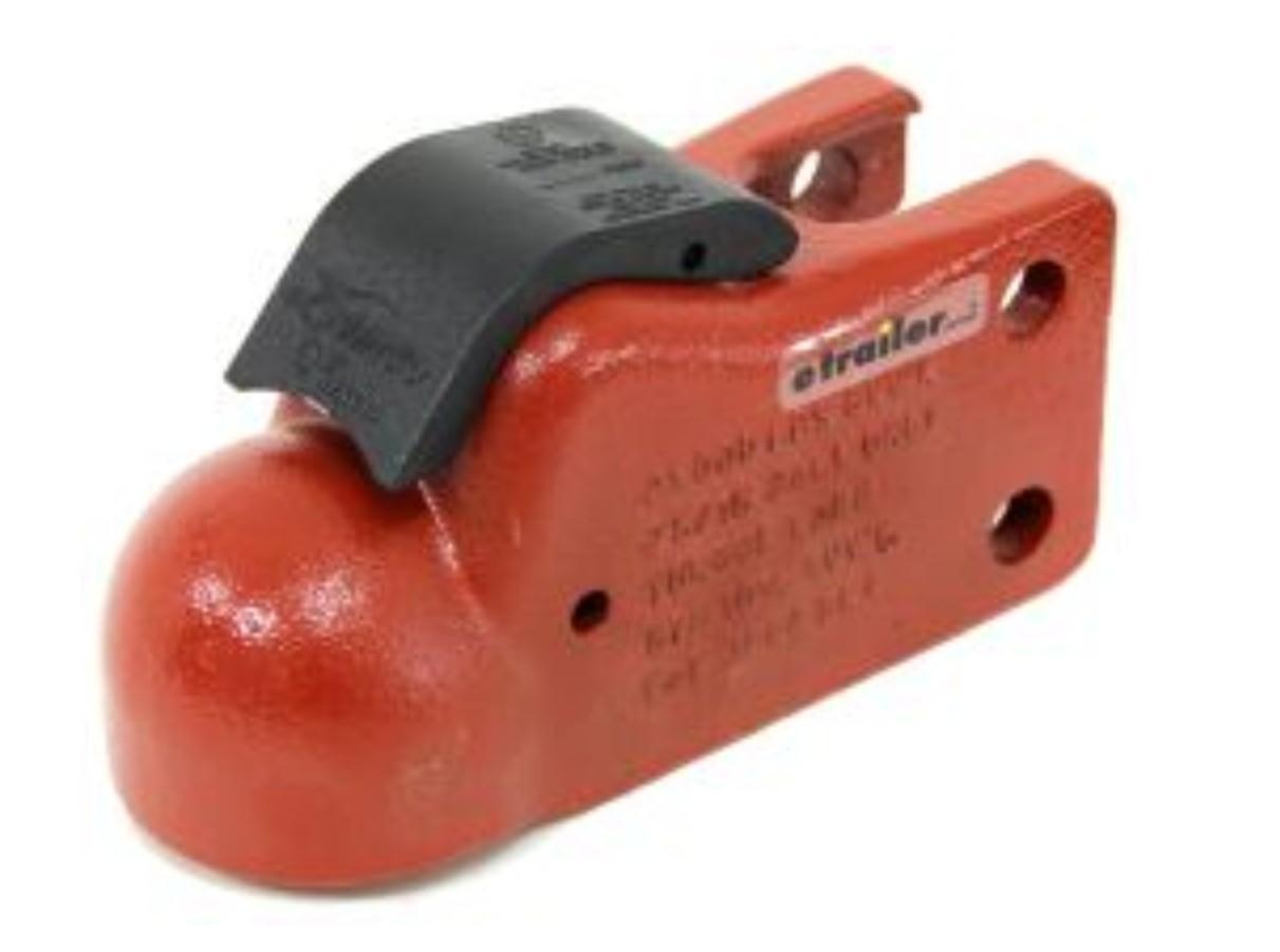

I think the issue is the position of the hole on that specific coupler. And of course its diameter is larger then most.
Which hole is the locking hole, the one on the flip tab, or the one beside where the ball is ???, and yes a padlock may not work there !!!

I heard back from Demco, they confirmed that the only couplers subject to the shimming fix were on Airstream trailers.
And yes, they stated that the locking hole is “oversized” to accept a 1/4” pin. I have a 5/16 non-locking pin in it now...but I’m not going to argue. I will come across one some day (or try someone’s 1/4” in it for reference) but I don’t want it to be sloppy.
