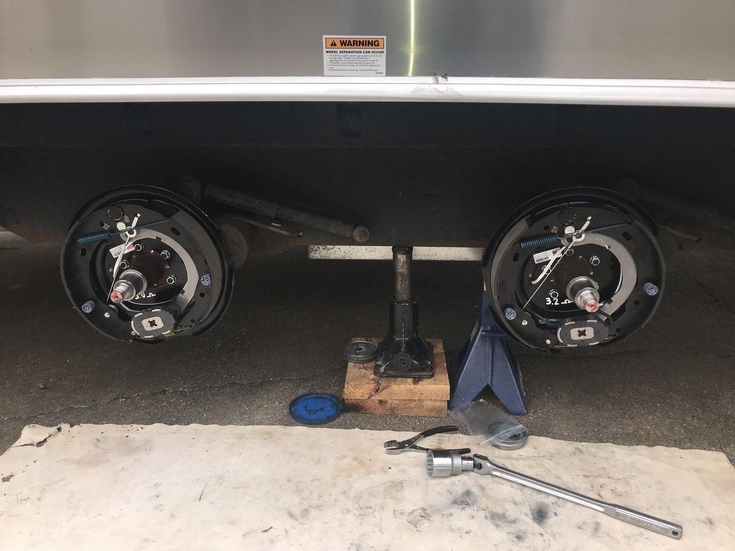

Circumstances and the owner’s choice were to replace all four brake assemblies with complete loaded backing plates and drums.
Backing plate removal, cut magnet wires very close to butt connectors, remove five nuts. New nuts were provided with new Dexter brakes. Clean axle brake mounting flange and install new brakes, left and right hand are different.
Replace drum. These Nev-R-Lube bearings require 145-155 lb-ft on the nut and my ½” torque wrench handled that. Replace the torque spec label and snap ring.

This became a real interesting project and we got to know Alan a good bit and had a good time and I learned a lot. The pic is with the new brakes, drums next.
