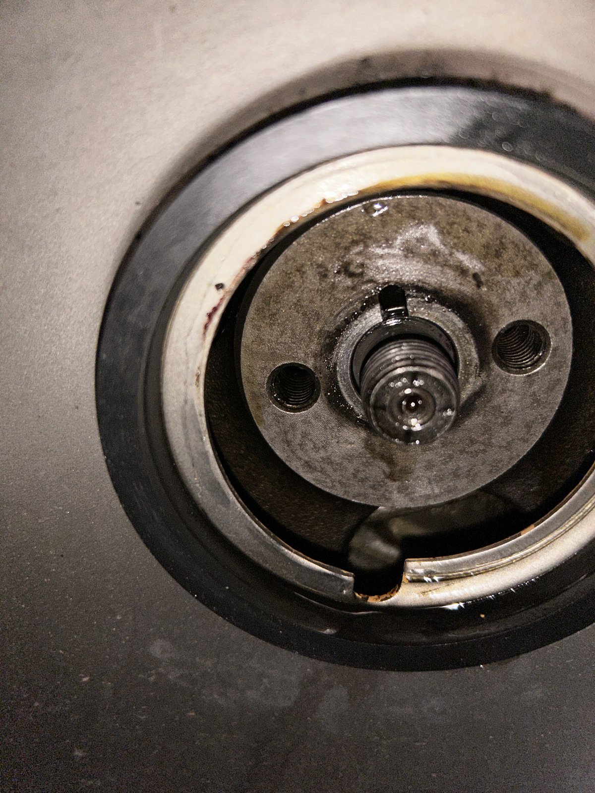

I pulled the injection pump shaft nut off, to add a lock washer and I was curious if the key way was there I couldn’t see down there but I have a small mirror and flashlight, it looks like the key way is missing
well maybe it’s in there I’ll post a pic

I looks to me like the key is gone, or sheared. Could just be the camera angle. You should see a lot more of it in the slot. Hopefully others will chime in with more hands on experience.
That Key does look like it's missing. Can you run a piece of wire through the hole to see if it's gone completely or just sheared off?
I have been told the keyway doesn’t stick up much, I ordered a new keyway and that makes sense after seeing how short the new keyway is. It looks like it may be in there still when I shine a light on a small mirror down there. I’m not certain though, so I might pull the timing cover again to check. I have been told I can use a steering wheel puller to remove the timing gear from the front and check this way? If I do this I will go ahead and jump a tooth and line the notch up with c, instead of e at this time
Yes, you can pull the gear with a small puller. You can't change a tooth without pulling the whole front cover, that's a big job. So is pulling the pump to change keys. I would leave it alone, if you can confirm the key it there.
