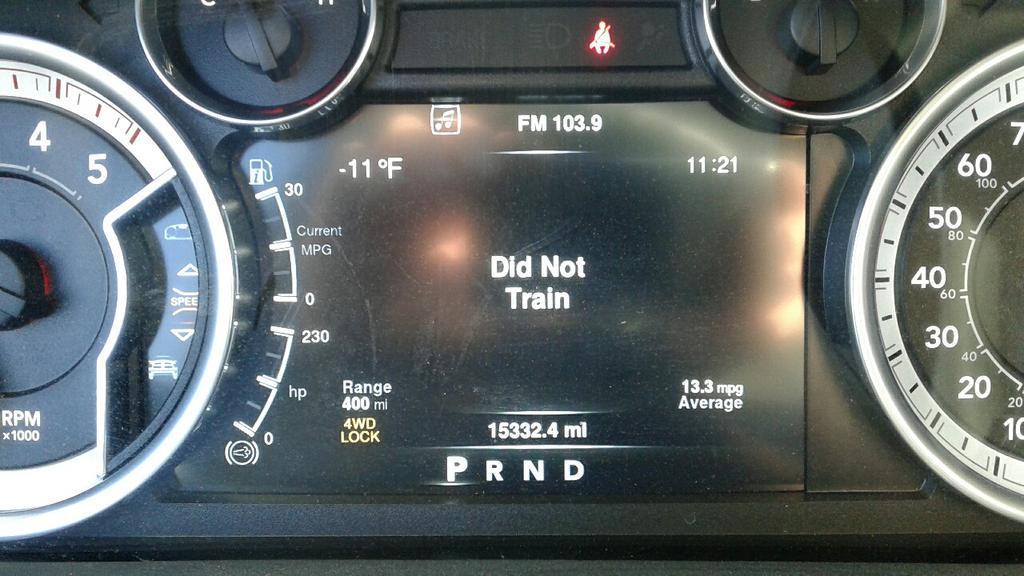

Anybody ever seen this one? Restart cleared it after sitting for 10 minutes.

I've had it happen a couple times. No rhyme or reason. Relates to the garage door opener in the overhead console.
-11F WTH. That cold I'm surprised to didn't get a "WTF you starting me this cold message!!!!" LOL I've gotten it a couple of times when I double tapped the garage door opener button in the OH console while trying to get the blasted door to open or close using repeated attempts.

Well, this problem is happening regularly now. This is not my truck. It's a 2016 3500 Mega-cab with 6.7 Aisin. Any ideas? Dealer thinks there may be a steering column problem.....but I doubt their diagnostic abilities.
The message has to do with your Homelink garage door buttons. It means that the truck and your garage door opener are not syncing.
My #1 button is programmed to our door. #’s 2 & 3 aren’t programmed to anything and if I push either of them this message appears. I don’t know if it means much coming from me tho, my truck gives me multiple messsges every day.
