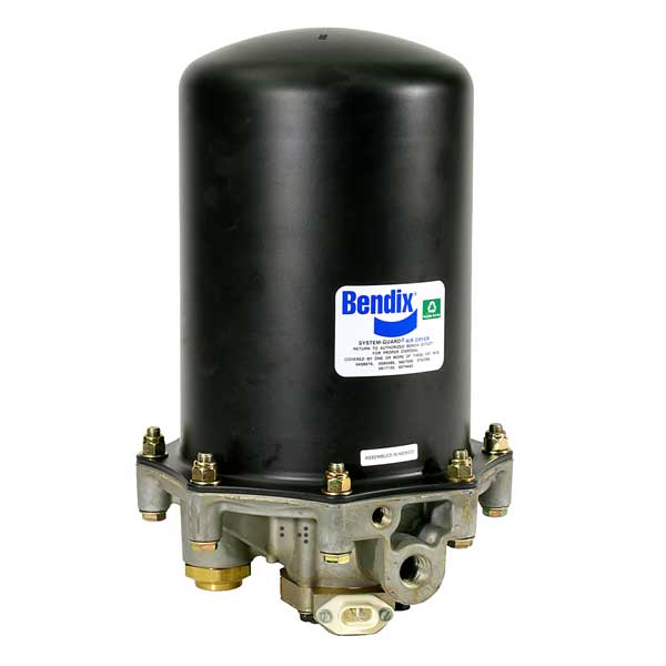

Anyways, for old school remote mount dryers you cannot beat the Bendix AD-9. None better. Simple, effective and reliable.
I am not fond of the Meritor / Wabco critter and we sell a lot of brand new Bendix AD-9 dryers to replace existing Meritor / Wabco units.

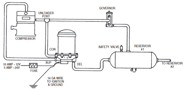

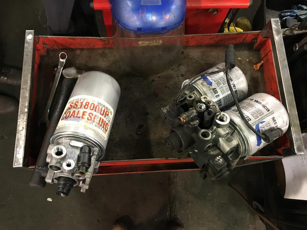

The wabco twin is a disaster. They fail and dump air out the bottom. We're restofitting the same but single with a purge tank that seems much better.
The AD9 is a good unit but a PITA to service. IMHO the best unit for extreme vocational service was the CR Turbo 2000 now made by SKF.

Then I highly recommend the AD-9 if you do eventually replace your current unit. As Wayns says it is not a simple spin off cartridge change BUT the AD-9 gives almost zero trouble. Replace the desiccate cartridge and purge valve every couple years and motor on.
It currently costs $77.90 for the Reman Genuine Bendix cartridge and purge valve here after core exchange less any taxes. That's a pretty cheap overhaul.
Beware, there are many AD-9 knock offs and REBUILT AD-9 dryers out there. I sell a brand new AD-9 Bendix unit for $249.00.
Not trying to sell anything, only offering the prices that BIG should pay a reputable seller.
