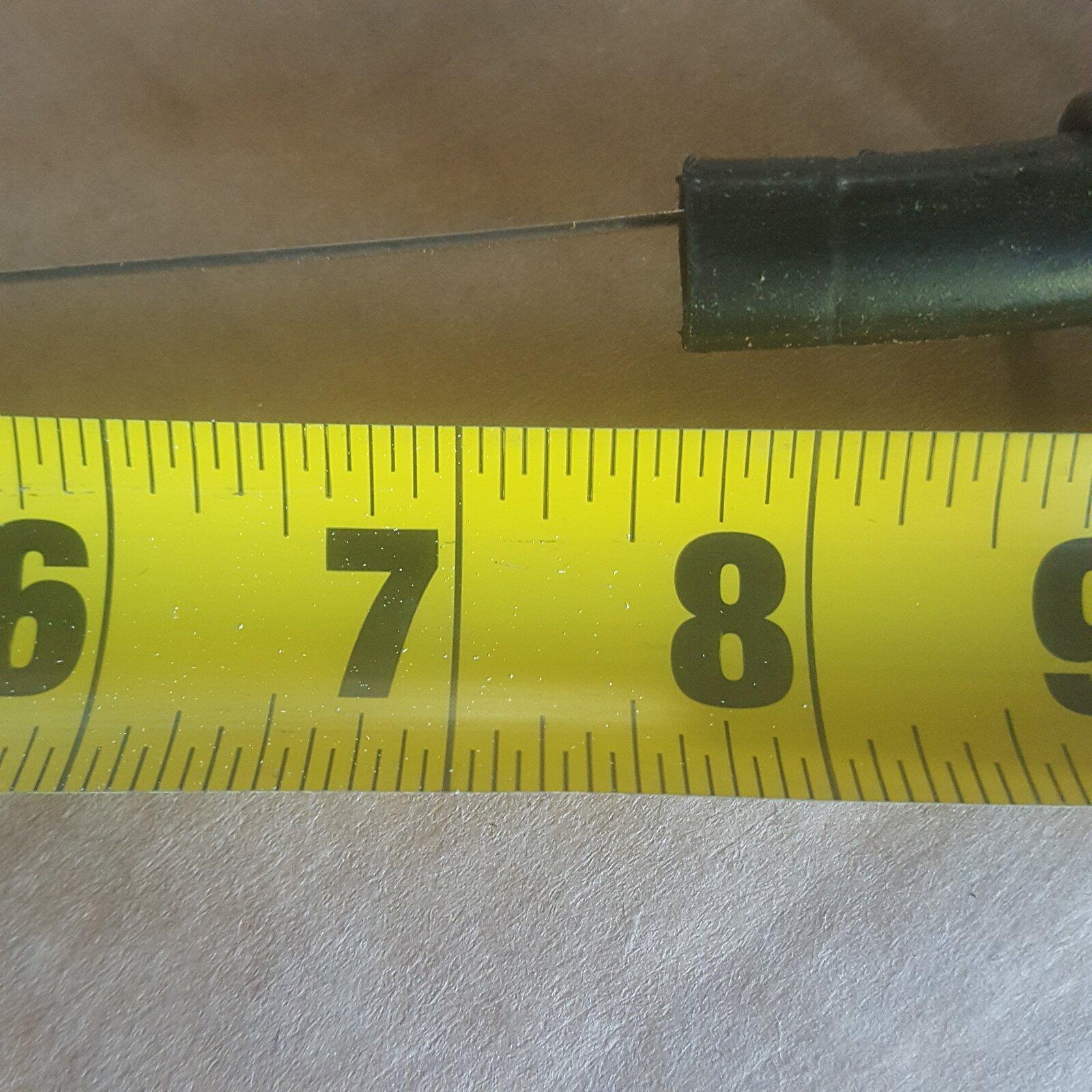

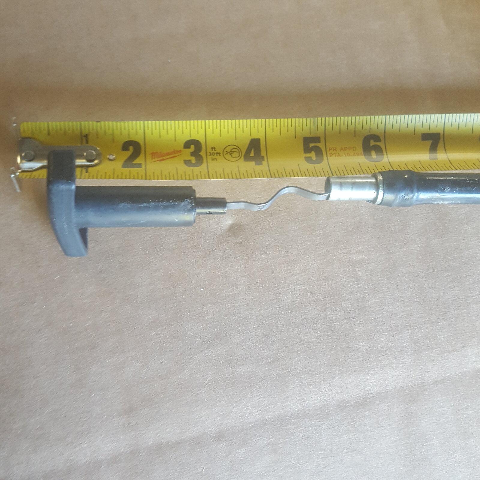

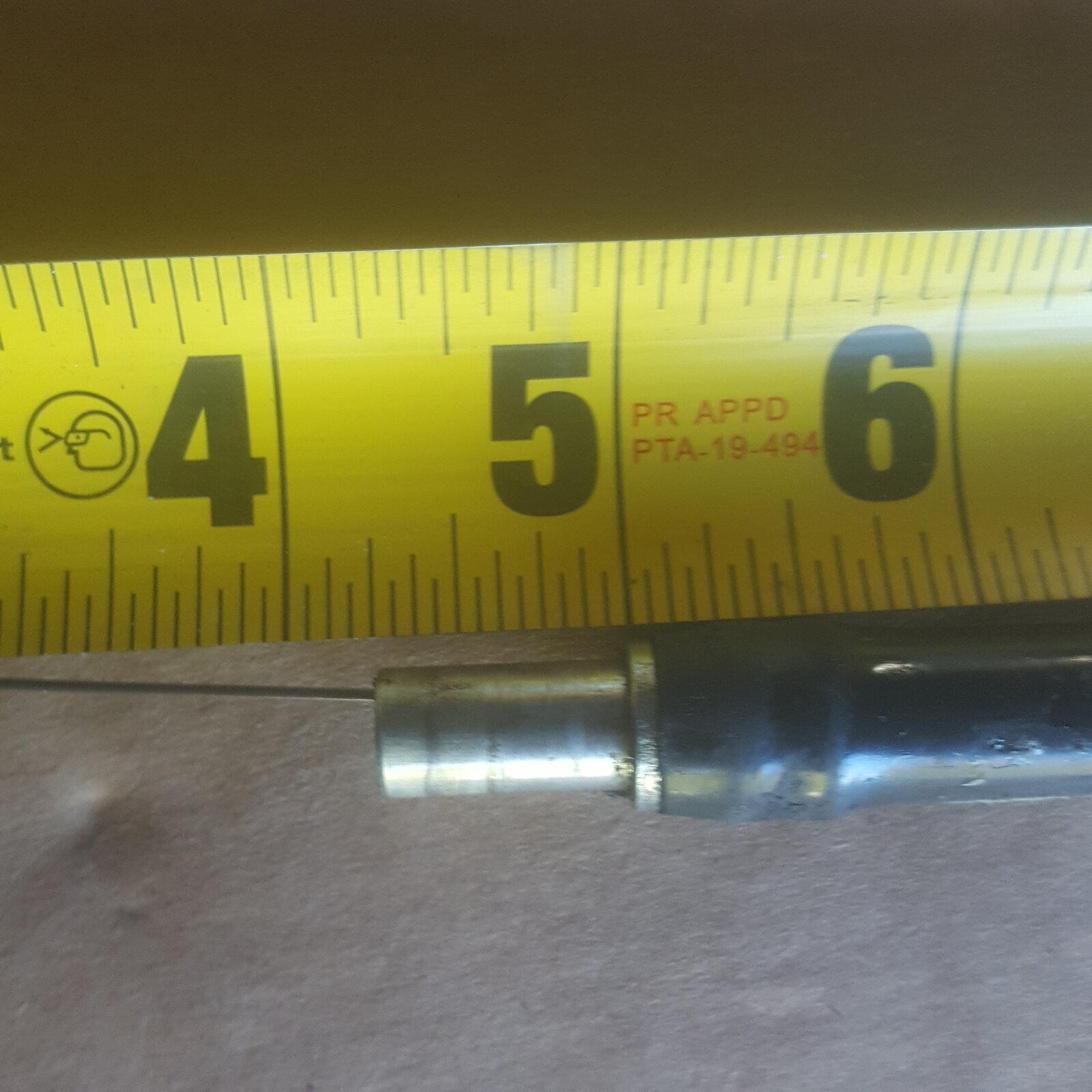

Here are a couple pictures of the dipstick, the 38" measures the black plastic tube, but the is also a metal insert there the dipstick goes. Here are a couple pictures the last one shows how far the metal dipstick extends from the end into the oil pan. 20220109_121602.jpg20220109_121609.jpg 20220109_121708.jpg
