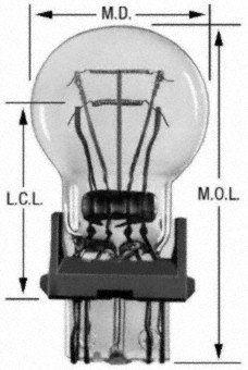

What brand bulb are the best? What ones are all glass without the plastic base?

My local independent auto parts store (Thirlby Auto http://thirlbyautomotive.com/) had a box of bulk bulbs just loose in a box. I don't know the brand, but it seems any that you see in the little blister packs have a black or gray plastic base.
I see the Sylvania bulbs have a glass base with no plastic. The Wagners that I've been using have the plastic base.
I checked Walmart and the Sylvanias there have a plastic base.
Wagners have a glass base with a plastic retainer.
