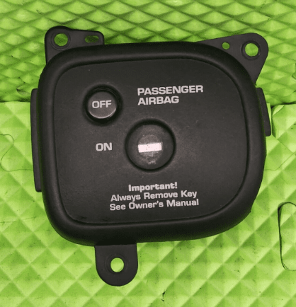

If your truck has the large cubby hole above the glove box, there is no air bag. As John said, the PS airbag and the switch to turn it off came with the interior remodel in '98.
