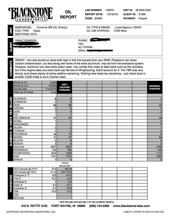

Well just for giggles I decided to send a sample to blackstone for my 06 and this is what I got back. I can't say I'm thrilled with the findings. Iron and Aluminum are a little high. I've been running a wix 4" pleat air filter in it and silicon is 8. I had lower silicon numbers than that with a K&N on my 97. I've been using Donaldson ELF7349 oil filters and this was the first time I used Lucas CI4 oil. This is the first sample I've taken with this truck so I don't have any baseline to compare it to. Thoughts?
View attachment 06 RAM 2500-011416 copy.pdf
