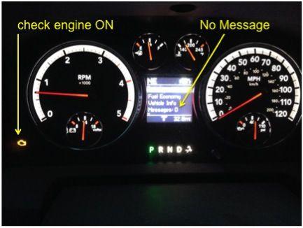

I’ve a check engine light on and have not been successful trying to display the fault codes on the Instrument Panel using the tried and true key cycling instructions used by our past Rams. More importantly, on this new model, which obviously has plenty of readable space on the panel, the fact that the check engine light is on does not even prompt a Message under the display menu is disturbing as a loyal Dodge user. This is a clear lack of Diagnostic and SW Engineering on Ram’s part and what they’ve sold us is clearly an unfinished design. If anyone from Chrysler reads this..as a fellow Engineer I’m not impressed.
So, I’m requesting that anyone who has successfully accomplished read out of the codes on the 4th gen IP please, respond with your methods. People who have older models, please do not reply with “it should work” as I know it should work.. but so far it hasn’t.
Take it to a dealer and have them hook it up to the WiTech. Most of the trucks from 2006 on you had to have a scanner capable of reading the ECU correctly to get all the codes. Nothing is easy anymore and you have a million mile umbilical to the dealer.

Well, it sounds like no one has been successful which tells me the software code in the panel just isn't there to write the information to the display. This is ignorant because the shared PCI bus mean all of the fault codes are shared between the truck's computers in real time and this includes the CPU in the display panel. For it not to print this information on the display is just plain sloppy work on Dodge (or now Ram's) part. If it was done intentionally in order to make us have to return to dealerships, then its just another example of corporate greed and I will consider leaving Dodge products altogether. When you spend a good deal of money on a truck, you expect that your getting a well designed, reliable and maintainable product. This is an example of RAM losing sight of who their customer's are and what they care about.

So trusty O'really's? tried pulling the code today using an Innova 3120 scanner and it came back with a P04DB saying the code definition isn't available. Now how difficult would that have been to print that out on the display? Not much I think.. probably the cost of a few of those WiTech scanners the dealerships have to buy just to read the damn thing. And think, Dodge could have added a nice Ram logo along side the code, just to cheer you up.
So in conclusion, it appears that the CEL codes are not accessible from the instrument panel for 4th gen Trucks. Just for those that are curious, it does appear that the IP will still run its built in test when you hold the odometer in and cycle the key from off to on. Obviously there is an Engineer at Dodge still trying to hold on to what works. Good for him or her.
