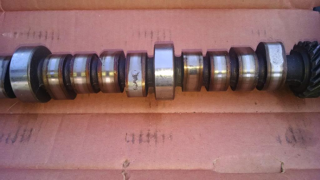

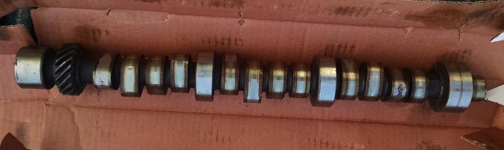

Pretty sure the camshaft's done. eXtremely Well Done. Sadly the owner is running a off the shelf Synthetic oil. Synthetic marketing term anyway... You could hang a fingernail on the camshaft where the lifters contact. :eek:

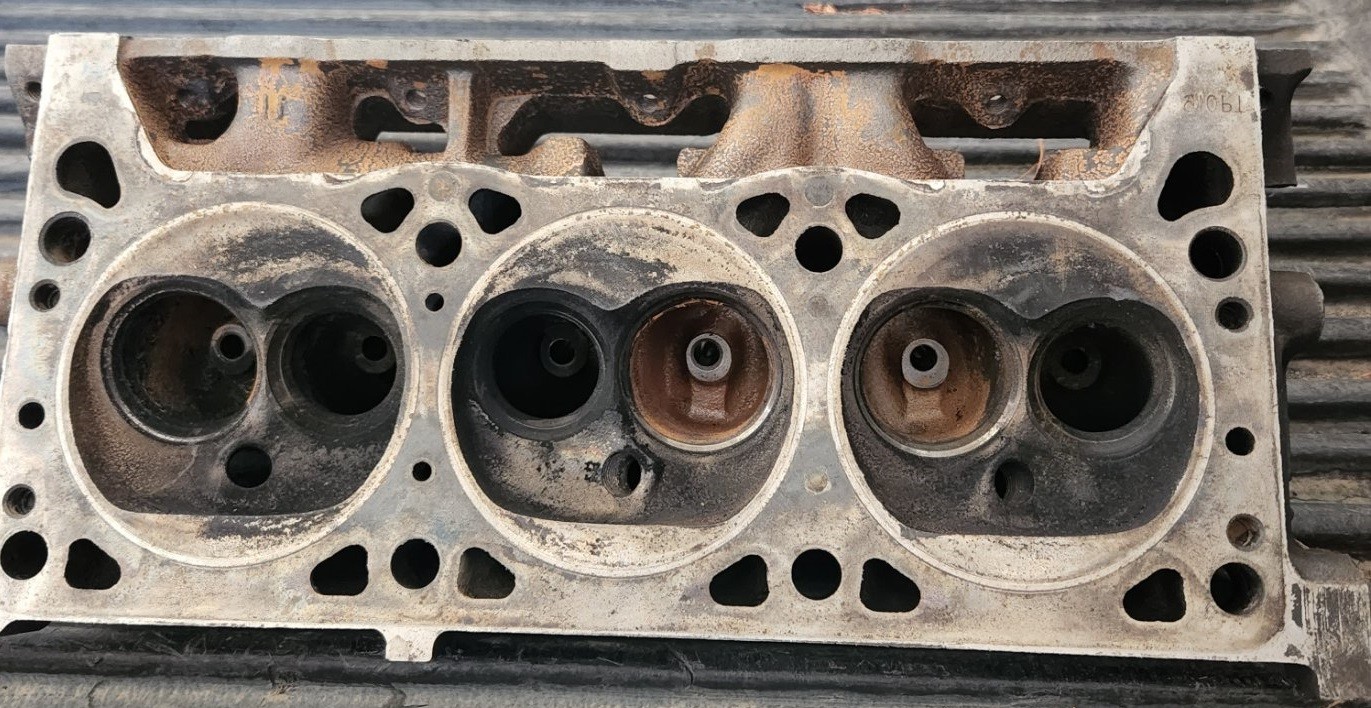

Block had a crack in a head bolt hole - scrapped.
Both heads had cracks.
Had to find a used block to build and they used new heads.
