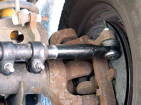

This is what mine looked like after the L-16 recall.
Newt
I suspect it is this: the tie rod stud and ball can rotate in the socket, like going to one end and the other of a slot, so you can turn the connecting link one way and the other vs. centered. If the two ends are installed with their studs at opposite ends of their travel, the linkage cannot turn. Just a guess.
I had the earlier recall and received new parts. With this new one I'm curious if it might include an alignment. I have a slight pull and am due for new tires. Just looking for my first "freebie" :-laf after being back to the dealer 5 times and still have a transmission problem#@$%!.
The picture show the correct installation position. The ones that break have the socket rotated out of line with vertical bolt and usually pointing at the ground, which is where they want to go if they wear too much. Taking the tie rod out of parallel with the plane of the tie rod bolt causes it to bind at full lock. Its not a taper problem, its not a component problem, it is purely mis-installation as there is no tabs to align the planes and keep it there during adjustment.

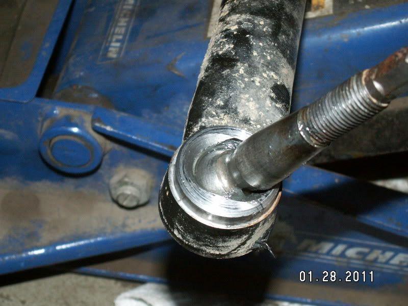

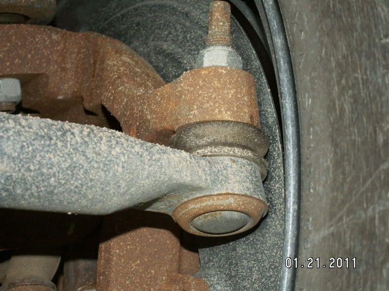

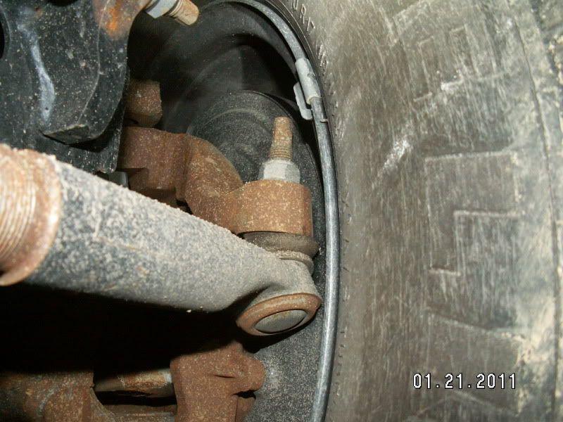

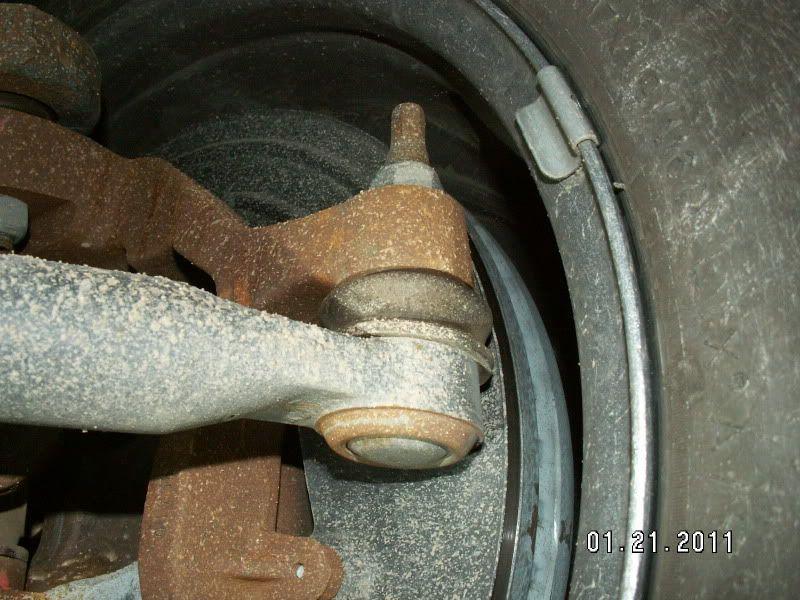

Old recall pictures
I think that this is the problem. I posted these pictures a few years ago when this problem first came about, but not much was done about it. And that is why the NHTS is now involved. As stated above. The alignment of the ball in reference to the stud is critical and causes stress on these parts. Causing the ball and stud to break usually in a right turn caused by the articulation pressure of the two. The recall was being done for a few years but it was noted that it should include back to 03 to 09? I think. This recall was not heeded as it should have been.
