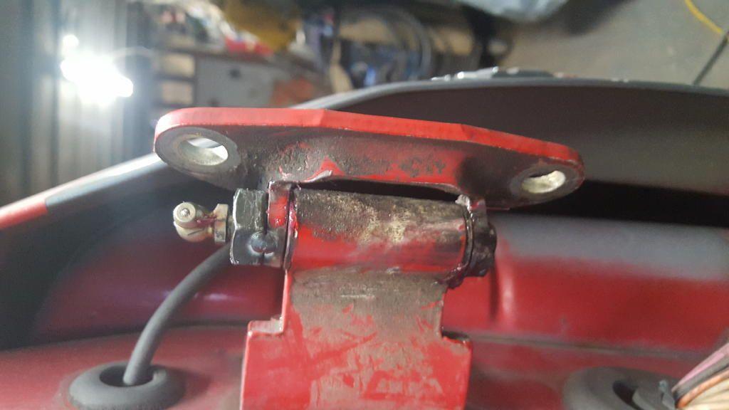

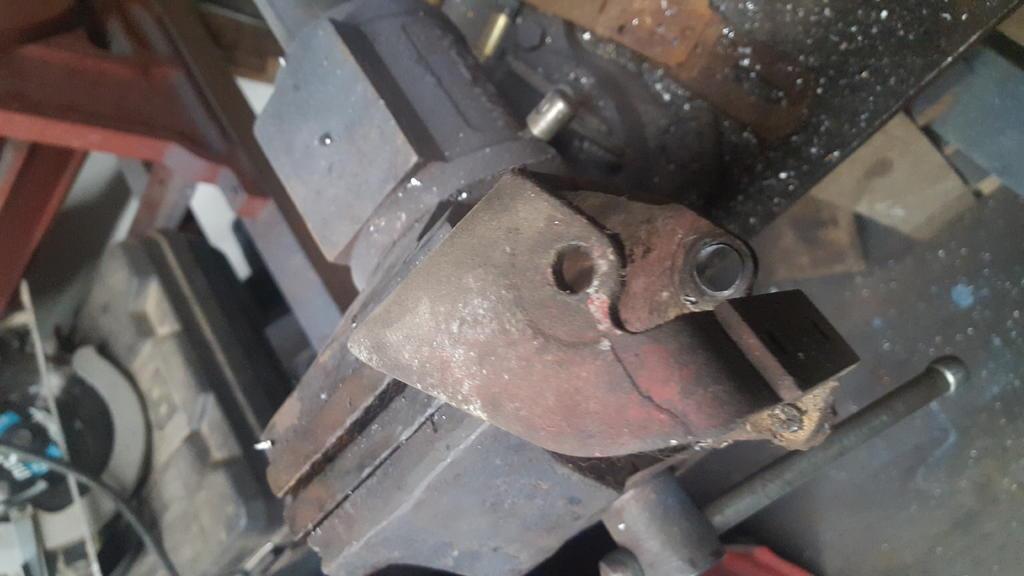

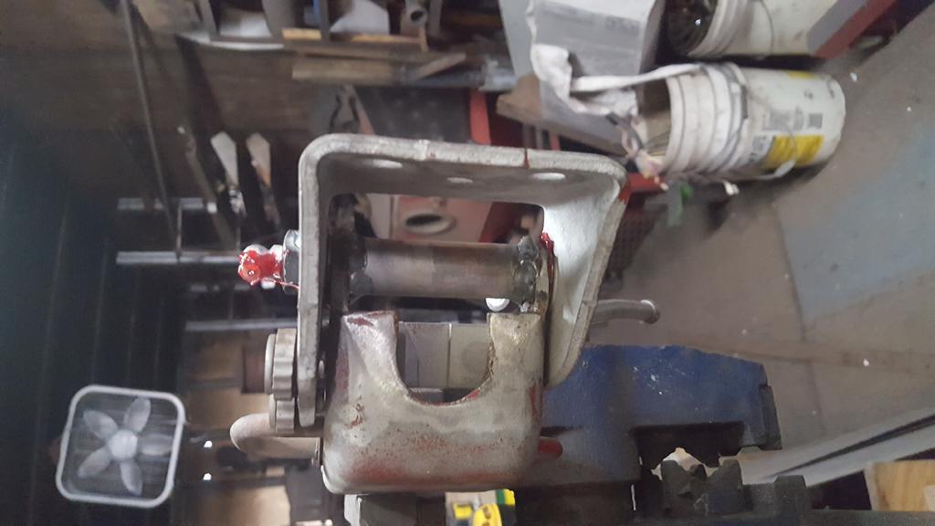

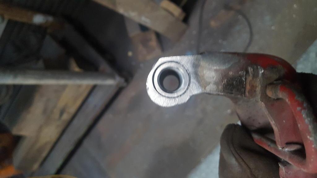

I'm wanted share my fix to a problem we've all had and some that you might not of had. Starting with my door hinges, which were worn so badly that the parts store repair kits wouldn't fix them

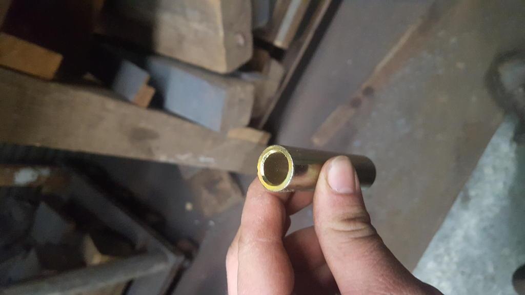

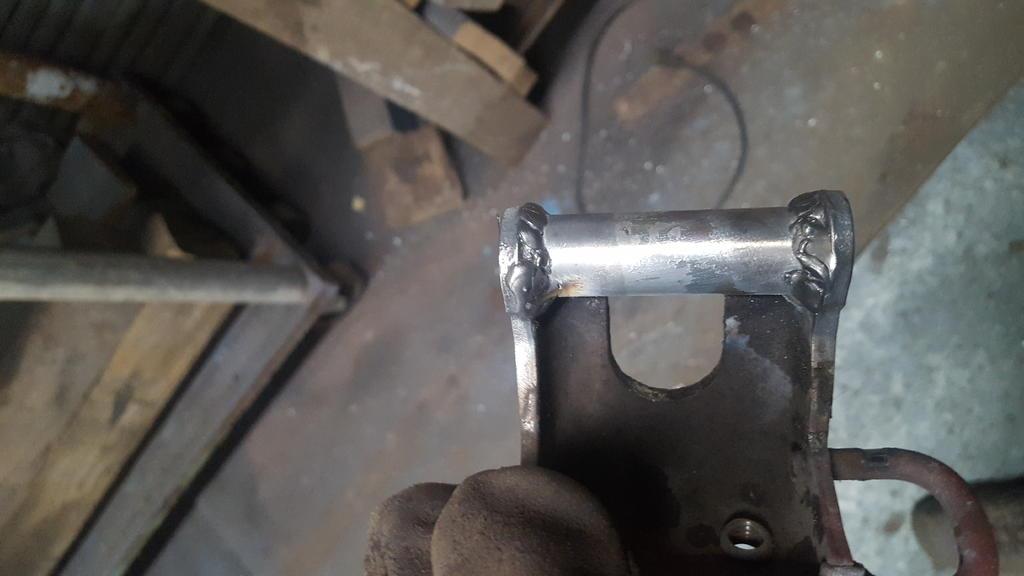

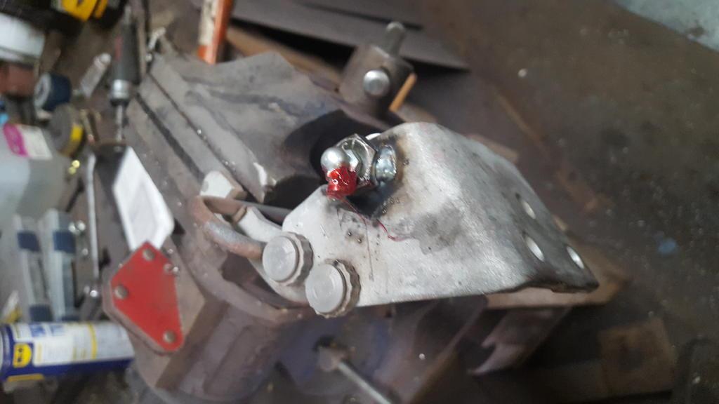

I started by disassembling the hinge then i drilled it out to accept the steel sleeve from a spring bushing and welded it solid
I then drilled out the center of a 1/2" bolt and crossed drilled the bolt so it could be used grease the pin and sleeve, once the hinge was put back together i welded the pin solid to upper and lower hinge arm so the pin could only rotate in the sleeve, i did the same thing for the top hinge as well.

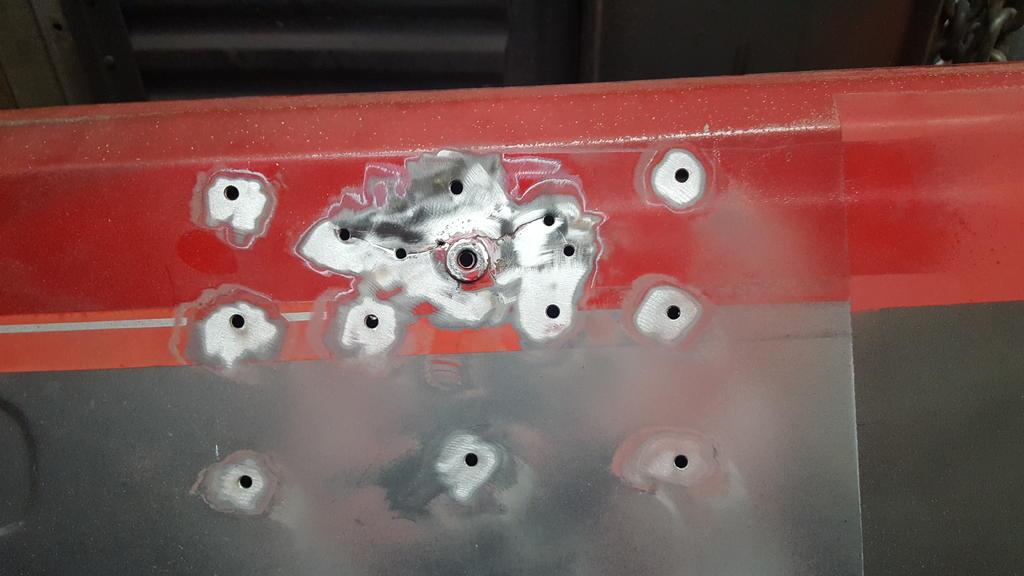

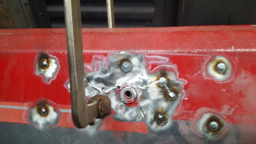

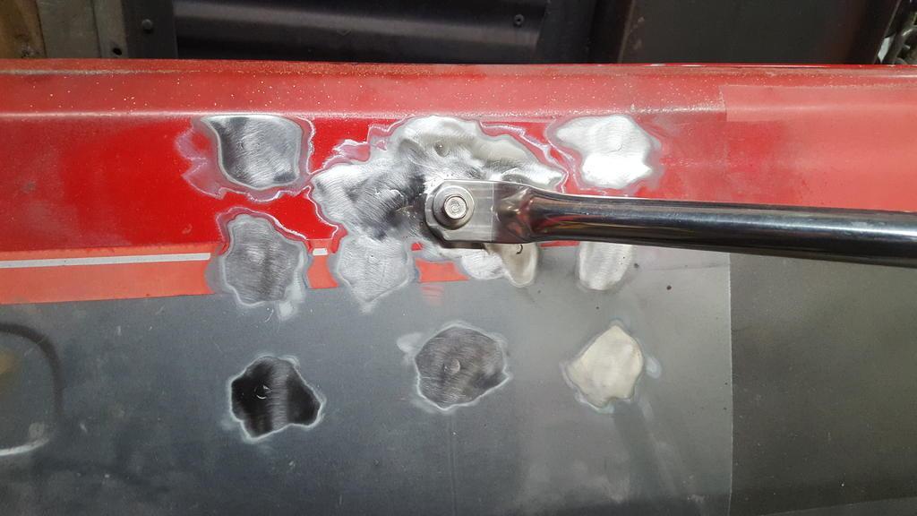

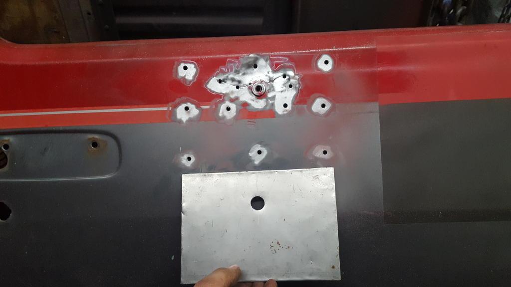

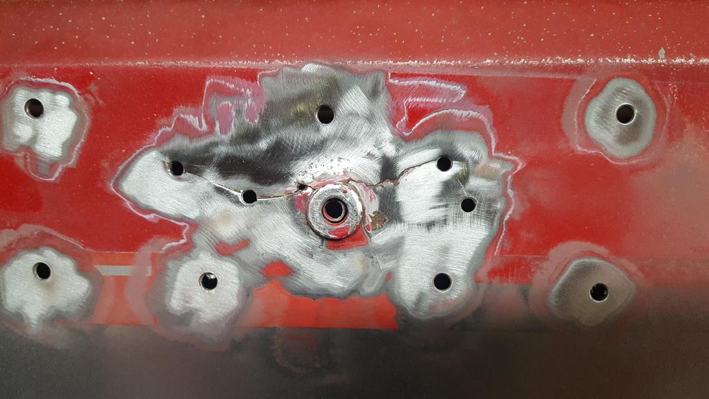

Up next is split in the right side door skin around a mirror mounting point
I started by drilling multiple holes into the door skin then making a steel reinforcement plate to go on the inside of the door.

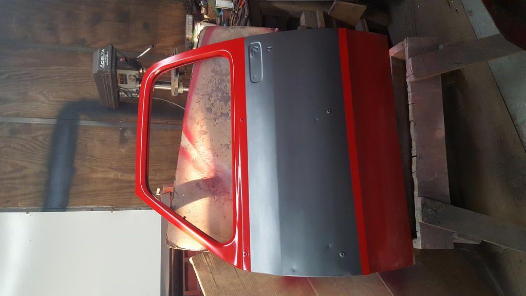

Next i welded the plate to the inside of the door though the holes i drilled in skin as well as welding solid the crack in the door skin and grinding all the welds smooth and repainting the whole door

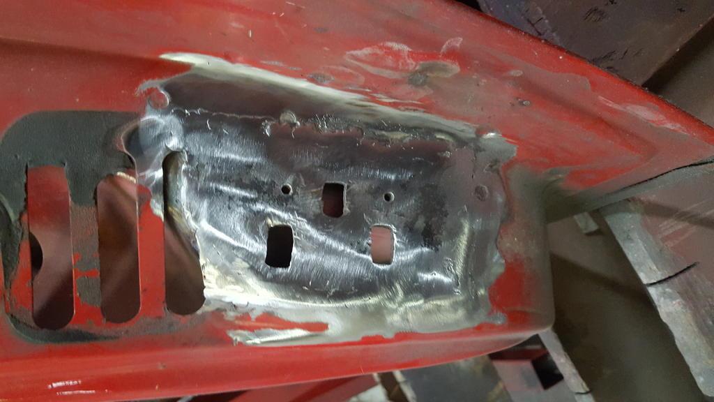

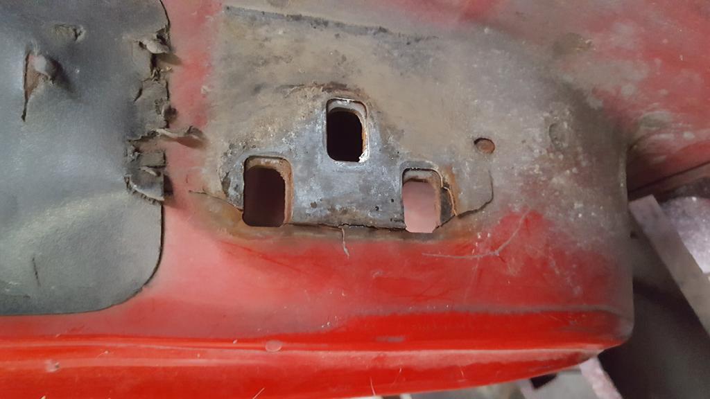

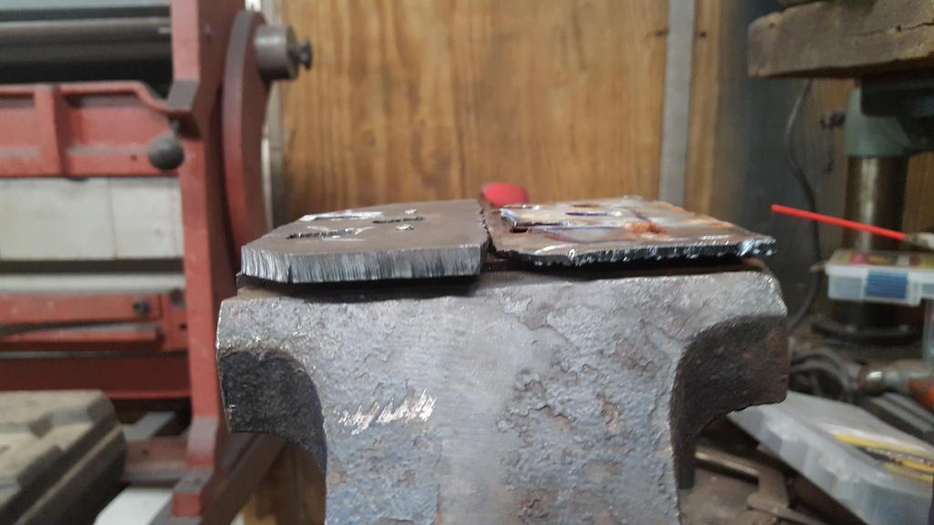

followed by the left door breaking out where the hinge bolts to the door

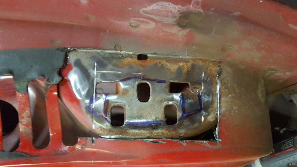

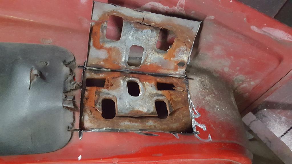

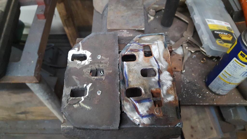

peeling back the outer layer of door skin reviled the extent of the damage to the inner support, each blue line is a crack in the door support
I cut out the damaged part of the door and traced the shape and holes onto a peace of 1/4" plate steel then cut it out with a plasma cutter and welded the new part in to the door and ground every thing flush for a finished look

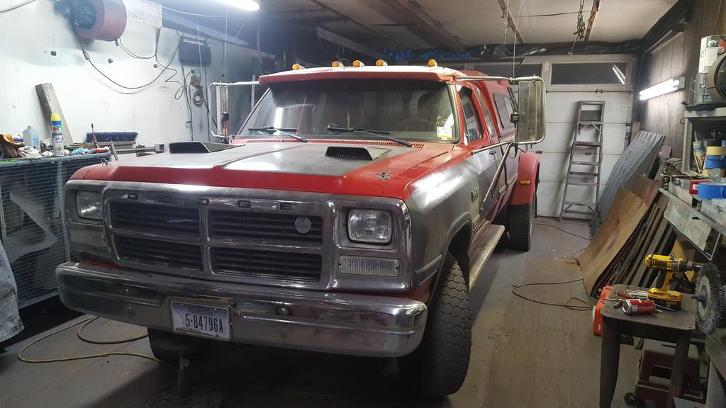

I also took this opportunity to upgrade to a set of power and heated Moto Mirrors from a Peterbuilt tractor trailer
