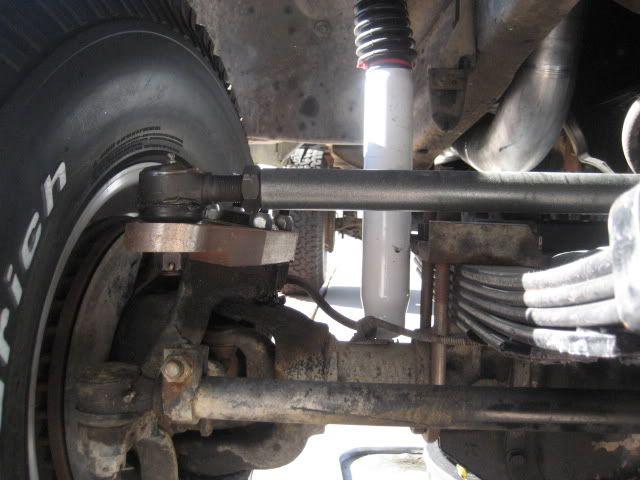

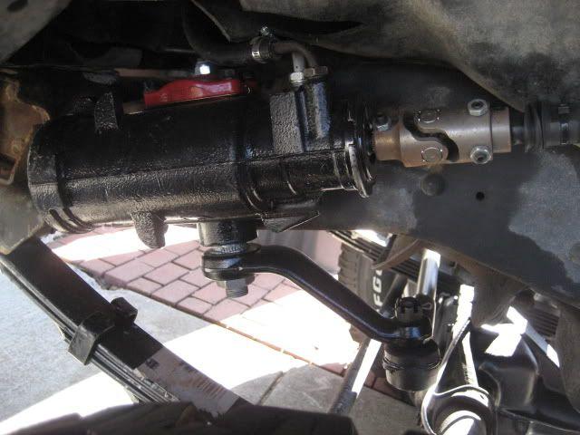

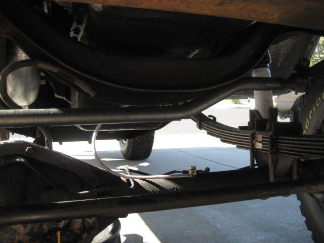

I found some pictures. A while back I was going to do a write-up on what I thought to be the end-all to steering woes but never got around to it. Here's what the crossover looks like in case anybody searches in the future. This has been done on many trucks with remarkable results.

I called Redhead directly for the box, they had it in to my door in just a few days i believe. That, the borgeson shaft, and ORD crossover is the complete ticket. That 93 drove better than anything i've ever owned. I had a couple older power rams that I would have to rebuild the front end every year. I never had this truck long enough to know how durable this setup is but it was like steering a sports car.
I wholeheartedly agree with the crossover steering. I did the conversion on my 12V powered 88' Chevy 2wd. You will need a 2wd steering box and the Offroad Design parts simply bolt in. My Crew-Cab was already 2wd so all I had to do was mount their drop pitman arm and steering arms for the 60 and I was set. Drives easy, straight and less wear on the box and frame. A must for oversized tires as far as I'm concerned.
Agree with Simplysmn, I've had boxes off 2 & 4wd trucks at the same time. Same box, just rotated 90 deg. & bolted onto that #@&* bracket rather than directly to the frame like 2wd.
