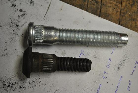

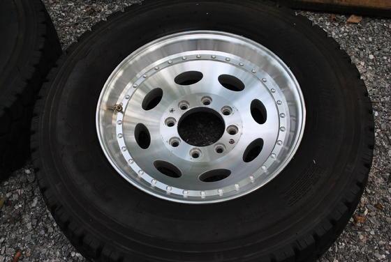

I inspected the front brakes, and mounted the Rickson's on the front of the truck... only to find out that the lug studs are not going to work. The new wheels are so thick, that I can only get 1 or 1 1/2 thread engagement on the lug nuts. I spent several hours searching for a 9/16-18 replacement stud that would work. From what I've found, there is none. The Dorman 610-283 studs are about 1/4" longer, but not long enough to give me a warm fuzzy feeling. Dorman 610-439 studs are about the same, except the shoulder is too short. I know I could get a shoulder style lug nut commonly used on Mag wheels, but quite frankly, I hate them. They're hard to use, are a royal pain, and I know just having them would disuade me from rotating the tires like I should. And, I would have to stick with a 1/2-20 lug.
So, the only thing that I found to work, is a Dorman 610-303. It is roughly a full 1" longer than the OEM lug studs, and is in a 9/16-18 thread. The only problem is that the knurl diameter is 0. 677" compared to the OEM knurl of 0. 651" front and 0. 658" rear. I found through reading, that the lug hole needs to be 0. 017" - 0. 027" smaller than the lug knurl diameter for proper spline engagement to lock the stud in place. Thus, I need a hole that is from 0. 650" - 0. 660" to press the new lug studs into. I also read, that according to some people, you should NEVER drill out a lug hole; rather, if the hole has to be enlarged, it should be reamed. I know that reaming generally gives a truer cylindrical hole; however, I only have to enlarge the hole about 0. 022". I can't think of a good reason why I can't drill them out on a press. Thus, I ordered a 16. 5 mm drill bit, which gives a nominal diameter of 0. 64960", or 0. 0004" under the minimum hole size. I figure I can use this bit to slightly enlarge the existing holes, and if the bit varies the cylindrical bore of the hole ever-so-slightly, I still have 0. 010" tolerance to play with and still be within the acceptable hole size for the new lugs.
Does anyone have a compelling reason on why this won't work? I did find an adjustable reamer that can be varied from 19/32" - 21/32" that I could mic and ream the holes if necessary... but I just can't think of a reason that it will be necessary. Am I missing something?

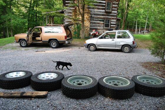

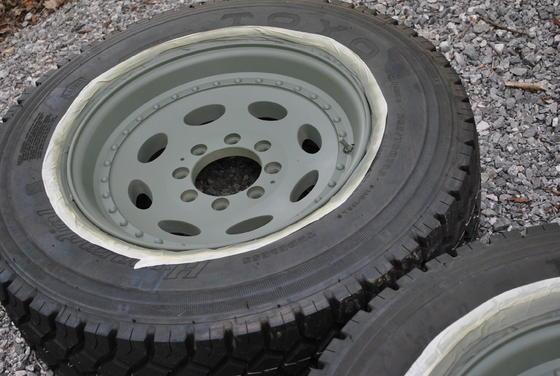

P. S. The pictures below are just to make the thread a little more colorful... and so I could try out the new upload-from-computer option :) Anyway, progress of the wheels transforming into matte black. The greenish color is a metal etching primer and adhesion promoter.
OMG, is that a Festiva in the background?????:eek::eek: Those have all rusted and blown away up here... .
Mike... :)
Sure is... I keep getting ready to sell her, and then something like this happens and I end up driving her everywhere again. At 216k, she's going strong as ever... and with the fuel injected 5-speed, getting 42 mpg to boot! :) I put a trailer hitch on the Festiva, and pull a 12' single axle trailer frequently. In fact, I've probably towed 80,000 miles with that car without a problem.
As soon as I get ol' Blue back on the road, the Festiva's going up for sale if you're interested ;)
--Eric
I would not drill them out id look at a longer stud such as the ones on oem fords or ones advertised on summit or jeggs maybe even strange engeneering etc
That's the problem... I looked for hours and hours and searched on multiple forums. The only offering of a longer stud is only 3/16" longer than what I have, and that simply doesn't give enough thread engagement. I don't really see any other choice?

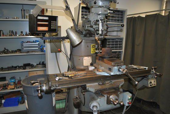

IMHO, for the money you have invested, a chucking reamer is coffee money. Buy the reamer, run it slow using aluminum cutting coolant, and do it right.
http://www.use-enco.com/CGI/INSRIT?PARTPG=INSRAR2&PMAKA=317-9782&PMPXNO=19503192
This is an American Made Reamer, BTW. There are others available at various prices.
Do you have a way of centering the hole under the reamer? Are you setting this up in a drill press or a milling machine? Dont do it with a hand drill motor and a drill bit! The holes will not be straight.

Yes, I do. I plan on using a big floor mounted drill press. I realize there would be potential for getting the holes off using a hand drill. I could use a reamer, but from what I read, a reamer cannot remove more than 0. 005" material... is that correct? If so, I the closest drill bit I can find under the reaming dimension, is a 41/64" bit... but that would require a 21/32" reamer to clean up the hole with a 0. 010" cut, which is twice the maximum recommended metal removal.
Again, if this isn't correct, please tell me. I'm mostly going off what I've read, and have done little reaming first hand.
The only thing I can find, is the adjustable reamer mentioned above that I could set to about 0. 003" larger than the 16. 5 mm bit. This would require drilling the 32 holes on the drill press, and then reaming 32 holes. I'm not opposed to that necessarily, but since there is a 0. 010" press fit dimension on the stud, I would think drilling on the small end of that dimension would offer the best fit. From what I read, the reamers usually have a + 0. 003", - 0. 000" tolerance. Thus, if I drill at 16. 5 mm, then ream at 0. 003" more than that to ensure the reamer cleans up the whole, and then the actual tolerance of the could be 0. 003" more than that, then the hole could be 0. 006" bigger (albeit probably more perfectly cylindrical) than just drilling.
If the above method would truly offer benefit, I'll do it. But it seems like a lot of complication for a seemingly simple task.

"a reamer cannot remove more than 0. 005" material... is that correct?"
No that is not correct. The amount you ream out changes with the diameter of the reamer. The larger the reamer the more material is removed with when reaming. I would not drill the holes out, use the reamer. You should have no problem removing . 010 with a reamer. Clamp the hub to the drill press table and use the chamfer on the end of the reamer to center on the existing holes with the spindle off. Raise the spindle turn it on and feed it as you feel it cut. Use cutting oil on the reamer. Don't worry this is an easy project to do. I am always surprised at some of the information that gets passed on to people asking questions like you are. I am a manufacturing engineer and have been in manufacturing for over 35 years. The first 20 I spent on the shop floor so I know a little about what is going on here.
By the way the reamer tolerance is +. 0003 not +. 003. If you want to check on any of this Google l and I reamer and look at the end of their catalog. It lists the material removal for reamers of . 500 to . 750 as . 012 - . 018. There are also speed and feed recommendations there.

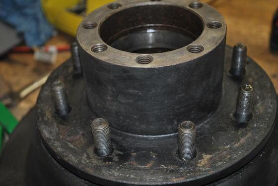

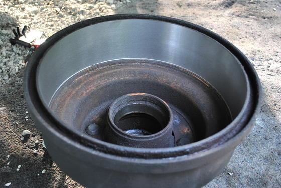

I actually dove into the rear hubs/drums last night and got them done. I still have to do the fronts. I wish I would've read your advice first, but I think it went pretty well.

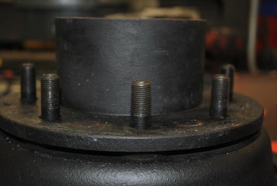

I'll spare everyone of the laborious details, because there doesn't seem to be much interest in upgrading to super long 9/16" studs for the purpose of running aluminum Rickson wheels on 1st Gens. Nonetheless, here's some pictures of the effort.
Well, I'm not getting along with the new way of posting pictures here... Here's the final result though.
This should give about 1 1/4" of thread engagement, even with the Centramatic balancers and Rickson aluminum wheels... and have stronger 9/16" lugs to boot! :)

If you didn't match mark the hub to the drum, you might want to get them machined. Any slight of center of the drum lug holes, might be a noticeable off center when put back together.
Good thought. Yes, I did think to mark the orientation of the hub/drum before I separated them, and I put them back together in the same orientation.
