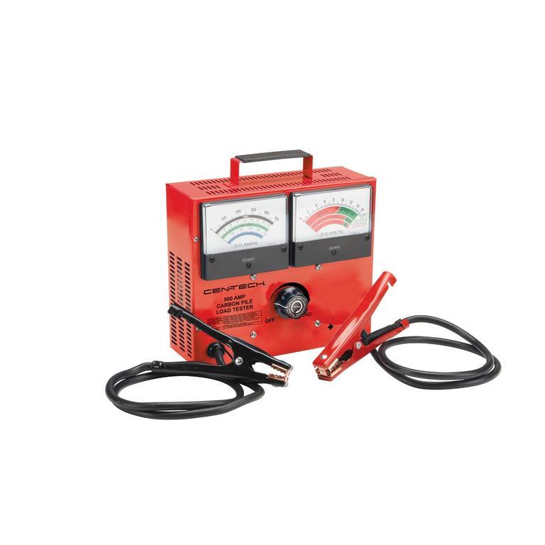

For $50.00 this makes life alot easier and you would use it for the rest of your life.
https://www.harborfreight.com/500-amp-carbon-pile-load-tester-91129.html

Cheap mans load tester. Disconnect both batteries, connect one at a time and turn on lights. Read voltage on meter.

I use exactly one of those for load testing and also like to use a battery hygrometer to check each cell when possible.

I work at a vocational high school so I'll borrow a load tester from the auto program tomorrow if I can. Thank you guys again, I hope it's something silly.
Just remember to disconnect batteries and test seperately with nothing else connected. You do not need any self inflicted problems.
