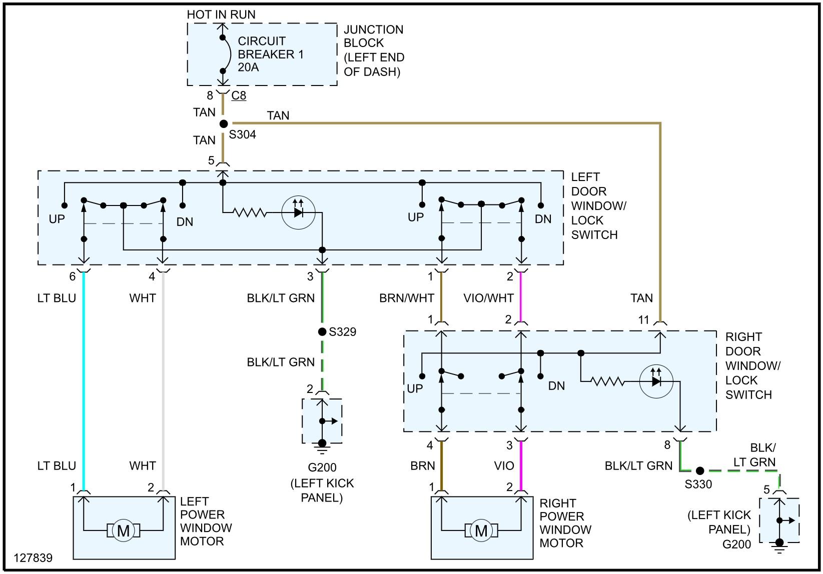

Looks like a pretty simple circuit.
Thanks for the drawing and the replies. I tried replacing the switch module as mentioned, but today I went out and held the switch forward and gave the door panel a couple of good whacks just above the switch assembly and the window started rolling up, and I got it fully rolled up. Apparently the motor is sticking and doesnt want to begin moving even though it's receiving the drive signals to do so. Maybe I need to replace the motor to fix this.. Thanks for the replies...
