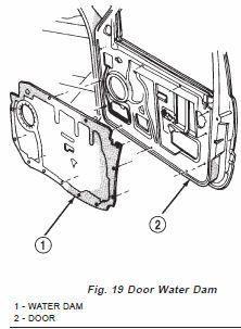

Water is getting into my driver's door and coming out between the door and inner plastic panel. This puts it on top of the door gasket and then it runs over to carpet, exactly the same problem you have.

I replaced the door seal before I realized it was running out between the inner door panel and the sheet metal. Obviously replacing the door gasket did nothing for the problem.

I think I know what is going on now after looking at my factory service manual. The inner plastic sheet is called a WATER DAM and I know mine is torn.
I think you're right, bboxall. The same thing had happened with my "water dam". It had come unglued at the bottom, and was letting water in there. $12 tube of silicone sealant did the trick. So far, anyway. But the amount of water that was dripping down into the interior of the door past that lower window weatherstrip does NOT seem normal to me. But then again, neither does calling that flimsy plastic dust barrier a "water dam". Oh, well. As long as my carpet stays dry...
Check the drain holes along the bottom of the door & make sure they're not stopped up. The belt strips aren't meant to exclude all water. The drain holes are outboard of the door seal and, if open, will allow water to drain out the bottom of the door.
