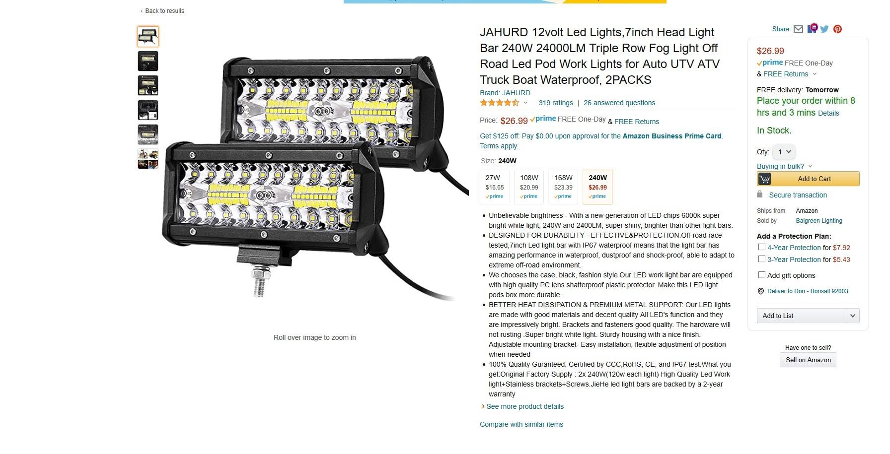

So I can cut these in the plastic spoiler area below .
Most led pods are not suitable for running in traffic as the don't have patterns with well defined cutoffs. Exception is Rigid DOT legal fog lights but they aren't cheap. The cheap led lights should only be used where you would run high beams.

Some people consider the factory fog lights to be driving lights. That is why I pointed out that the blob pattern LEDs shouldn't be used with the low beams. The Rigid DOT legal fogs can be though as they are fog lights just like the factory fogs. I agree that these days for true driving lamps, led is the way to go; however, for long range the halogen and HID pencil beams will beat the LED for range. I have Rigid hyperspots combined with Spectre Driving lights on my truck and the Hella Black Magic with 100W bulbs I have on my jeep reach out further and frankly do a better job of illuminating the roadway for high speed driving with their bow tie beam pattern. The Spectre do provide a wider close range beam than the black magic does so are nicer for forest roads. Lights are all a trade off.
