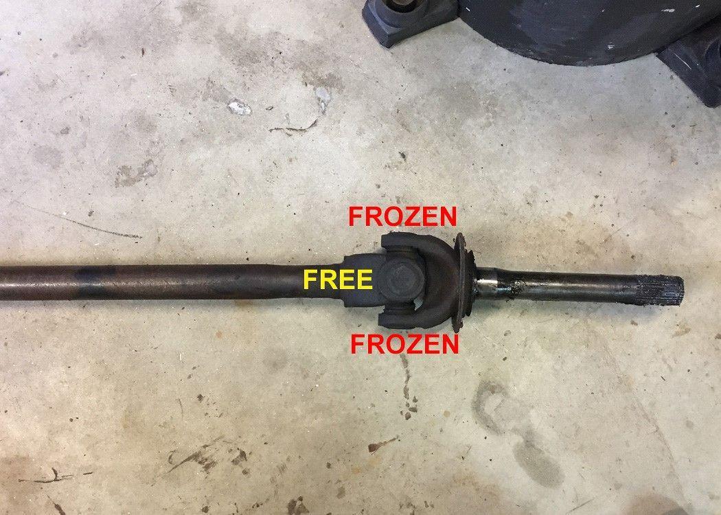

This was cause of my Drunken Steering issues... Started out as a small wandering issue, but overtime it got worse as the joint got stiffer and stiffer. Eventually it forced me to take the truck off the highway, and later off the road entirely until I could sort it out. It wasn't one of those things you just check in place. I didn't discover it until I physically pulled the shaft and tried to move it.
