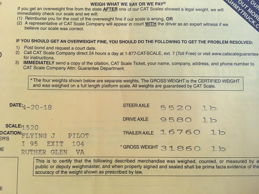

I stopped at the Flying J and weighed the new trailer yesterday. Keep in mind, I installed my Onan 12Kw in the bay so she's a little heavy. The GVW of the truck is 15,100 with the Truck and Transfer Flow full. My pin weight is 5350. I'm close on the rear axle. I may move the B & W RV 3600 Companion Hitch one hole forward to shift
ALWAYS run the hitch fULL forward on a long bed. That means the straight edges of the head supports are towards the cab.

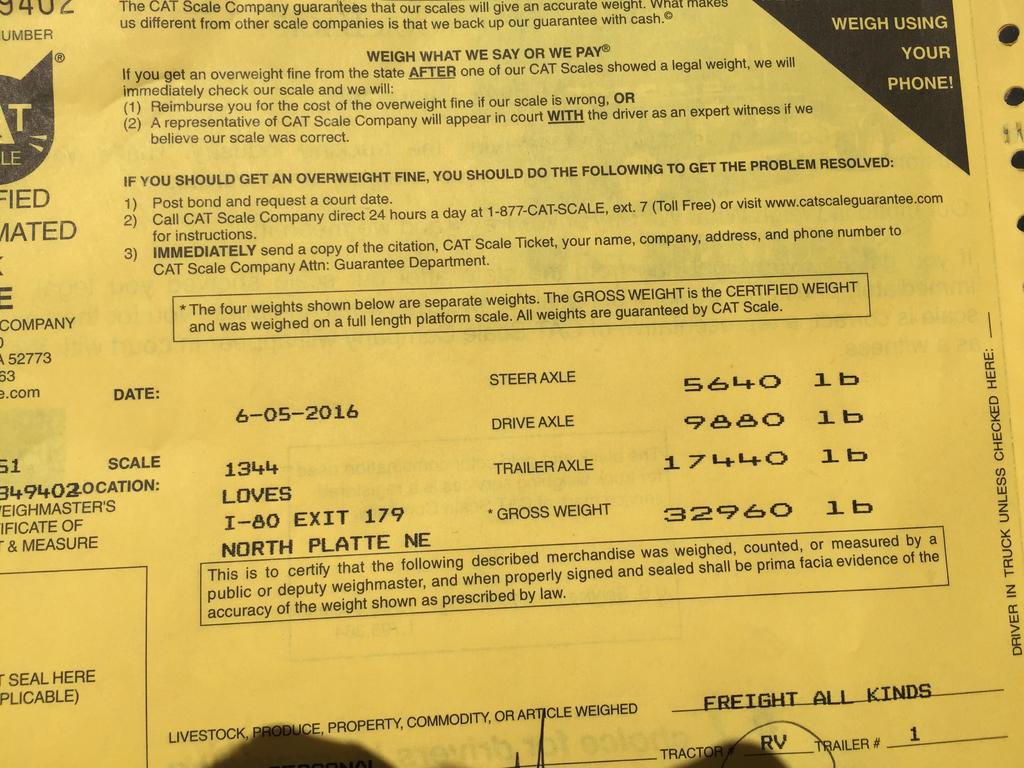

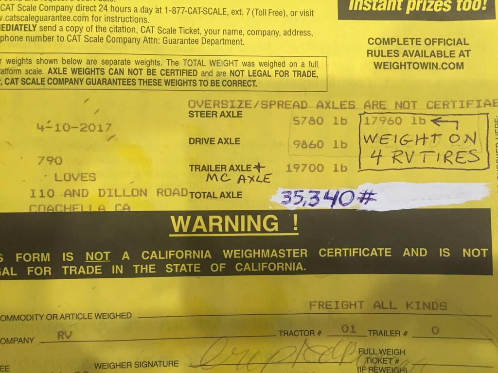

I got you beat by a little bit! Second pic is with my MC Trailer in tow.
