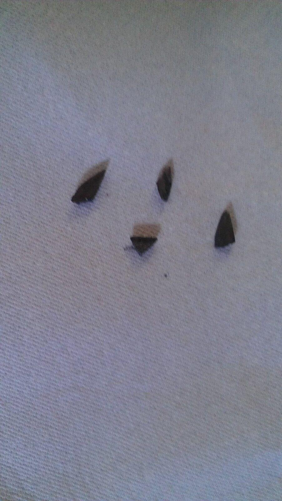

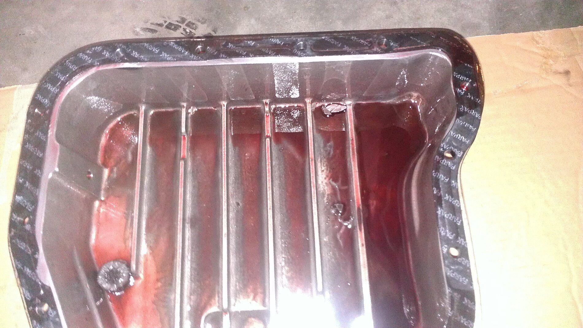

My first clue was strange shifting when cold. Here is a picture of my second clue.
It was the piece on the right in this picture of the direct drum that had been milled down to add additional clutch plate that broke.
