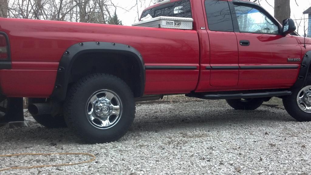

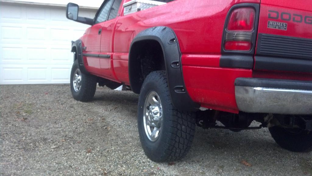

Not very good pics but all I have for now of my bed rails and bottom 4" of the truck MonstaLined
While I have not tried it either, if I needed to roll on a liner, I would use the Mosterliner instead of the others.
